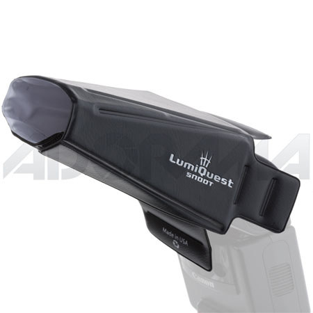

Are you talking about something like this but made out of cardboard?
Yep, except it's rectangular all the way down. The length and size is about equivalent to a stack of saltine crackers.
I'll upload a pic later.
