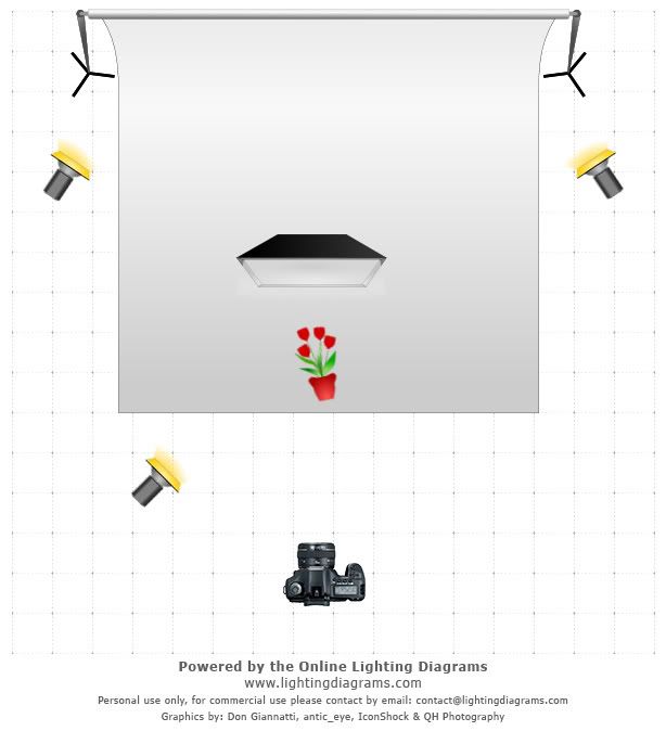

Please suggest the power of the bulbs also as I will end up buying anything. Will it be ok to use 2 x 125W(525W equ) Daylight Bulbs for the softbox for the subject and slightly higher bulbs for the background? If I use these continous lights I hope there won't be any use to use the main lights?
You will need a main light for your subject, what are you shooting ?
Can you please send me some links to the background lights as you said "bare speedlights or monos with aluminum bowl reflectors ".
I am shooting products. Clothing on mannequin.
Yes mainly it will be using white background. The mannequin I am using is now black but there will be one white one as well.
Something like that. I can't help you with the wattage, I really think you're over your head in this. Check out websites like B&H or Adorama for speedlights or monos. I imagine you're hoping to do this with a few lightbulbs from walmart, which I don't see happening for a full size set. Who knows, maybe you can work it out :)

Yep, you need more light on the background to keep it white in the photo. >SNIP>
Yes, more light on the background will make it appear whiter.That is one way of accomplishing your goal.
A second way is one I use a LOT, but which many people never even think of. It's called "key-shifting".
If you keep the SAME amount of light on the background, but use LESS LIGHT on the subject than you were using, the RATIO of background-to-foreground lighting will change.
This will also require an exposure adjustment to brighten up the foreground subject; so to compensate for the LOWER light you are using on the foreground subject, you will need to open up the lens OR elevate the ISO level a click or two or three. (or a combination)
A good example would be a backdrop lighted by 2 x 100 watt lamps, and a foreground lighted by one 75-watt lamp...background is not white enough...so, you SHIFT the foreground light downward to a 40-watt lamp, and elevate the ISO two clicks....BOOM! Pure white background.
