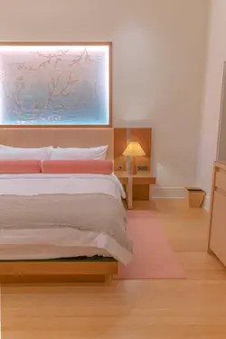

I'm shooting the interior of a bed and breakfast and the space is pretty tight, resulting in some really challenging shots. I need a photo facing each bed, but this one in particular is so close to the opposite wall that I had to take three separate vertical shots and am now attempting to merge them together to create a horizontal shot of the bed. I used a 24mm lens and removed the fisheye in Camera Raw, but I'm having trouble merging them due to the differing perspective of each shot. Any idea the best way to merge these shots while making the bed look large and inviting?

Both ICE (Image Composite Editor) and Lightroom C will merge the images. The LrC result was compressed horizontally. I made the Lr one broader in Transform but left the ICE one as-is. It might be possible to get the result you want.
ICE version
LrC version
I think the problem you're having is because you moved the camera to a different spot in the room for each photo.
Try staying in one spot and take the three photos from there.
Another thing you could try, if 24mm is wide enough, turn the camera horizontally and take an upper and lower photo and merge them.
It may work, it may not.
Yes, as davev said, the images MUST be from the same point for stitching to work. After all, the point of stitching is to produce an image of what you saw while standing there, and you can't do that if the other images are from elsewhere. The perspective changes, and the stitching software has no basis for the merge.
Also, fisheye makes lousy source images for stitching, even flattened out on the computer. Beg, borrow, or steal an ultrawide. I have a 10-24DX that I use for such shots and it's perfect. Your widest zoom or prime lens in vertical might work well, too, maybe you'd need more than three frames.
