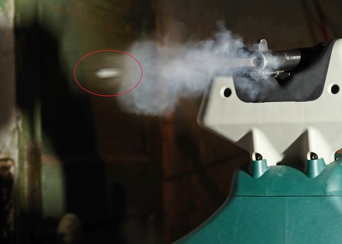

I've circled the bullet here......
This was with a sub sonic .22 out of a handgun. The bullet speed on this was less than 500fps. If you are shooting anything of a harder caliber than that, it will be moving MUCH faster. .45 will be 800-900fps, 9mm will be moving 1,000fps or so etc. If ou get into rifle country, a pill from a .30-06 will be moving close to 3,000fps.... so you can see the issue here.
Unless you have absolutely no ambient light, and a flash capable of over 1/100,000th of a second burst of light ($3,500+ microflash), I say you don't stand a chance. Sorry!

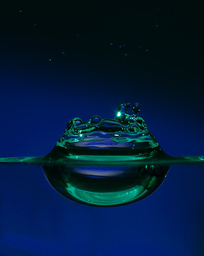

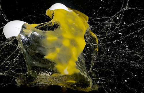

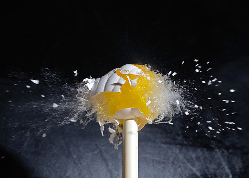

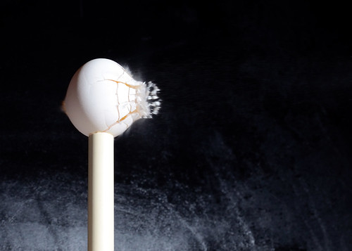

All of these images were taken with long shutter speeds, and the only source of light was a short burst of light from the flash. Much faster than any shtter speed my camera is capable of.
6.1 second shutter speed.
1/60th shutter speed.
1 second
1 second
2 seconds
I could go on, but I think those make the point. Fact is, in this type of photography, shutter speed really has nothing to do with the image captured. As long as the shutter is open when the light source fires, you will get the image, regardless of ho long it is open.
