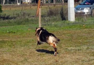

Hi,
I need some help on how to take better and more clear pictures of dog sports....
I've already shearched the web, but so far the results I got with my camera aren't any good... :grumpy:
I have a Fujifilm Finepix HS20 EXR. I've tried using the Shutter Speed and Aperture modes, but the pics I get seem like "oil paintings".... :raisedbrow:
Here's some examples:
(Shutter Speed: 1/400 sec; Exposure Program: Shutter priority; F-Stop: f/6,4; Aperture Value: f/6,4; Max Aperture Value: f/2,8; ISO: 200; Focal Lenght: 29,1 mm)
(Shutter Speed: 1/1250 sec; Exposure Program: Shutter priority; F-Stop: f/7,1; Aperture Value: f/7,1; Max Aperture Value: f/2,8; ISO: 800; Focal Lenght: 30,3 mm)
(Shutter Speed: 1/1250 sec; Exposure Program: Shutter priority; F-Stop: f/6,4; Aperture Value: f/6,4; Max Aperture Value: f/2,8; ISO: 400; Focal Lenght: 23,0 mm)
This next pictures were taken in a very rainy and windy day...
(Shutter Speed: 1/180 sec; Exposure Program: Normal program; F-Stop: f/5,0; Aperture Value: f/5,0; Max Aperture Value: f/2,8; ISO: 1600; Focal Lenght: 69,1 mm)
(Shutter Speed: 1/200 sec; Exposure Program: Shutter priority; F-Stop: f/5,6; Aperture Value: f/5,6; Max Aperture Value: f/2,8; ISO: 1600; Focal Lenght: 74,7 mm)
(Shutter Speed: 1/71 sec; Exposure Program: Aperture priority; F-Stop: f/5,0; Aperture Value: f/5,0; Max Aperture Value: f/2,8; ISO: 400; Focal Lenght: 32,7 mm)
This last one was one of the few that are "usable"...Still if I zoom it to the full size, the hairs of the neck near the collar also seem to have a blurry effect...
Hope someone can help me out, and tell me what I can do to take clear pictures... Thanks!!! :hail:

It is hard to look at resized shots and see anything definitive but, since I see nothing in focus) my guess would be that there are several possible reasons 1) motion blur because of subject speed, 2) camera shake or 3) the camera didn't achieve focus on a fast-moving target.
Have you gotten sharp shots before and since with this camera on other stationary subjects?
Are you trying to focus on the moving dogs as they are moving? This is a problem with bridge cameras due to the delay from the time you press the shutter button to the time if actually takes the picture, known as shutter lag. By the time it takes the picture, the animal has moved slightly from where the focus was locked. You keep tracking the moving dog, but for that small split second the camera does not change it's focus.
On an agility course it's going to be somewhat easy to try to fix since you know where the movement is going to happen. Prefocus on the spot where you are looking for the action, and a hair before it gets to that spot then press the shutter button. This should allow for the lag and get the shot as the dog crosses into the area in focus. A good place to try this as an example is your second shot over the obstacle, prefocus just in front of the item, and as the dog crosses over the top press the shutter button. With some practice you can get the timing really close.

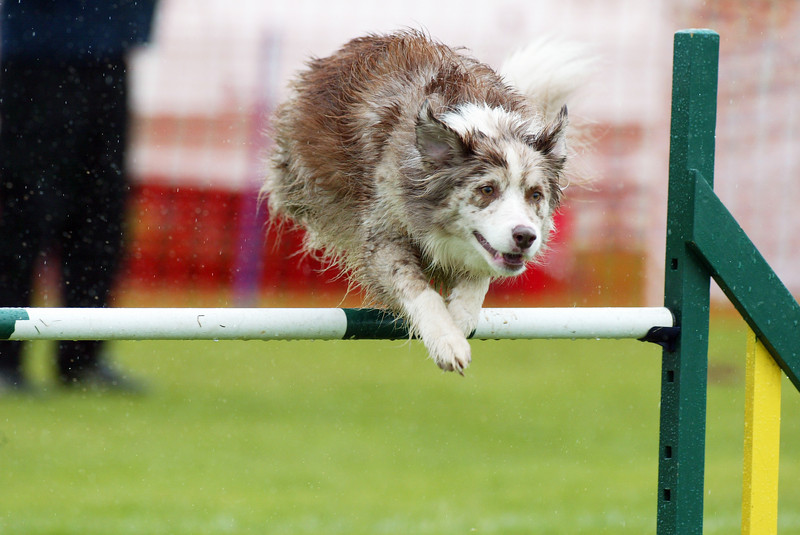

With that camera you will struggle, you need to get closer and use shorter focal lengths to keep your aperture wider for faster shutter speeds, you will need to turn off auto focus and manual focus on the jump and because of shutter lag press your shutter early, I have shot dog agility too many times and try to keep my shutter speed no lower than 1/640, i use top end gear 300mmF2.8L 1D and still prefocus to get the shots
Here's one 1/1000 F4.5 iso500

beautiful dog!
not so great focus. image is soft.
