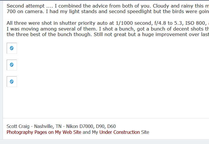

Images don't show and both links in your signature don't work for me.
Try Photobucket.
Images don't show and both links in your signature don't work.
Try Photobucket.
It must have just been momentary since I never noticed it. I'm about to come down hard on my hosting service. They started out 100% reliable and are falling hard now.
I'll pass on Photobucket, but thanks for the advice.
The reason I mention Photobucket is so I will at least be able to see the images...
EDIT - for some reason the only way I can view your images is with Jeffrey's Exif Viewer.
Cheers, Don
