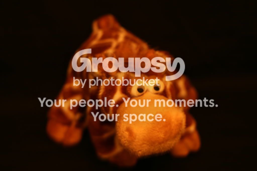

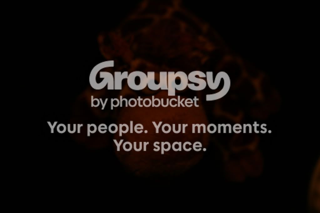

I am shooting from a Canon Xti, 50mm lens with a 430ex speedlite. Maybe the speedlite is programmed wrong and it affecting the slaves? Both the speedlite and the studio lights are new to me this week. The lights are only a couple feet from the toy. Is this too close or too far maybe? I should probably bump up my ISO it is currently 100. Also they did come with a PC cord, but I was using my speedlite to trigger the slaves. Here are some examples that I just took- (please ignore the fact they are OOF! My tripod is currently MIA.)
Both lights fired and this is with the speedlite postitioned towards the toy.
This one is with both lights firing and the speedlite aimed at the ceiling.

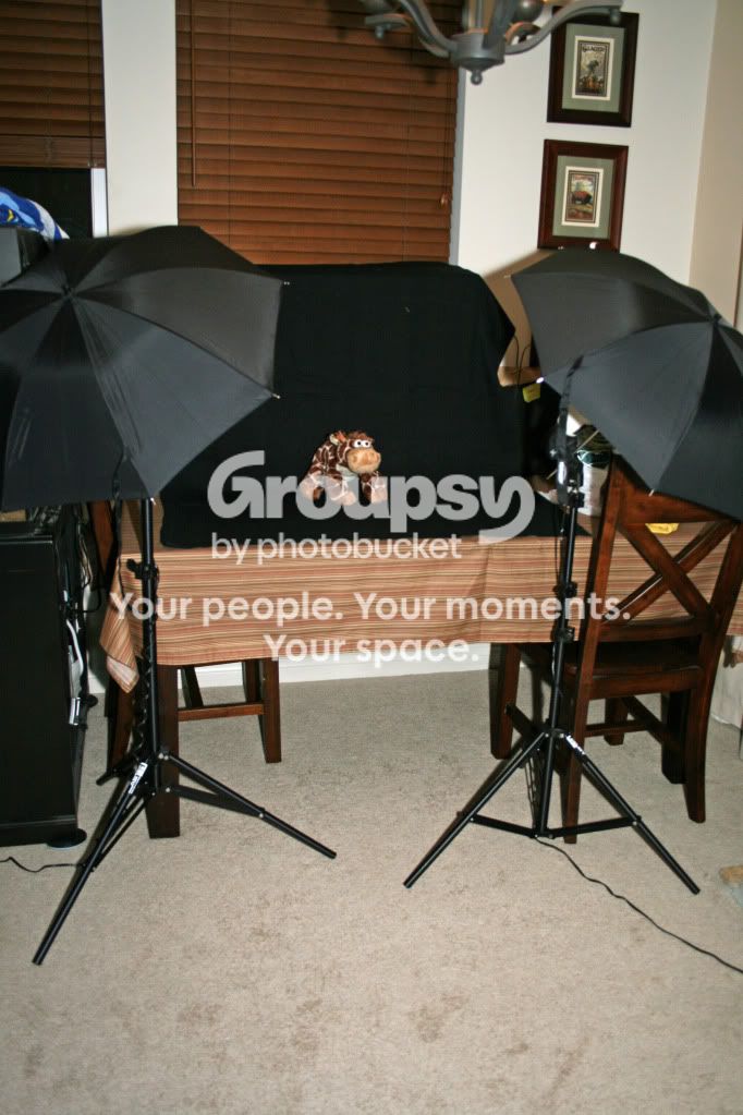

Here is a pic of my set up-

Looking at the photo, two, 45 watt-second lights positioned that close ought to be illuminating the subject quite well--enough so that there would be detail in the black background material you are using.

Just a note on your set-up. Your umbrellas aren't pointed at your subject, they are pointed well below your subject.
That means the lights are feathered, not delivering a full measure of the available light to your subject.
To get it all, point the shaft of the umbrellas directly at your subject.

Okay, I noticed the terribly blurry eyes in shot #1, which was made at f/2.2 at 1/3 second in Aperture Priority Automatic, and the second shot was at f/4 at 1/60 second in Normal Program mode. Both shots were shot in the wrong mode--you need to shoot in Manual exposure mode!!! Why? The 430ex flash is firing a pre-flash to determine the correct exposure,and this is the cause of the problem.
To correct the problem, you need to shoot with the camera's 430EX flash set to a manual power level, which will disable the pre-flash, as I stated above,and as another poster stated. It might "look like" both flashes are firing, but we're talking about milliseconds of delay, and the flashes might be firing but they are firing before the camera is making the exposure. This is a common problem--this is NOT the first time I've heard of this, but about the 10th time.
Try setting the camera to manual exposure mode, and pick a shutter speed of 1/125 second and set the lens aperture to f/8 and the ISO to 200. Set the 430EX flash to manual mode--you can NOT trigger slaves if the flash is in ETTL mode! THe flash must be set to a manual power; try 1/8 power and see if that is enough to trip the optical slaves--it probably will be.
