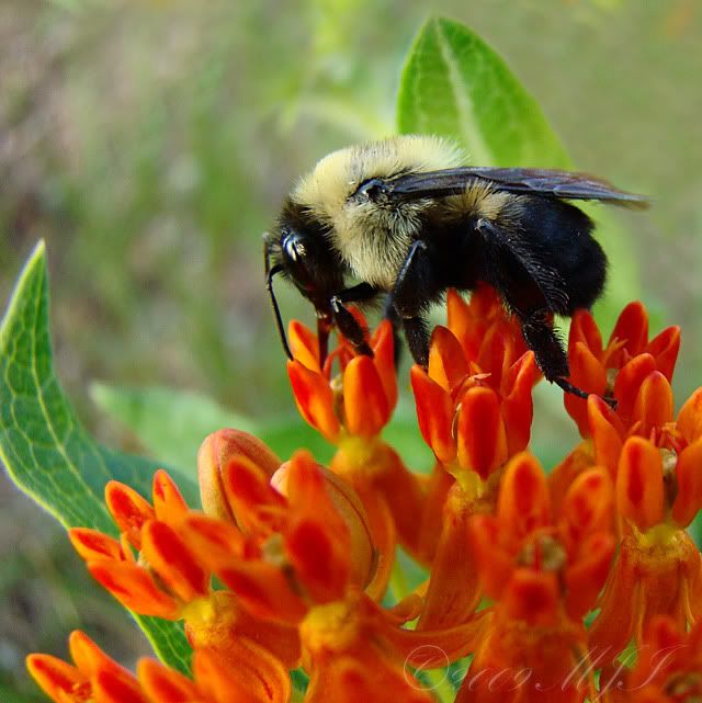

I like the edits done to the bee. I've used the clone tool with some of my art, but lately I've been shying away from adding too much alteration on my photos besides the unsharp mask and some occasional brightness, contrast or levels tweeks.
So..... you do enhance your photos then, correct? Then cloning, cleaning up, cropping, pops with all the usual tweeks is only trying to do that.... enhance your photo.

I did hit the sharpen filter too, forgot to mention that.
I'm not quite a purist. I find just straight from the camera usually is a little too soft (even if in "perfect" focus - I think because of it being a JPG), and may have some lighting/contrast issues. Other edits I do for online sharing such as resizing and adding a watermark with my usrname.
As far as cloning I haven't used that on my digital photos lately, except to blur out real names and streets for internet protection, but I did try it just now.
Besides the top flowers, I cloned out the blue "glow" around the leaf behind the bee.

The bee on the other hand (#1), I had my camera right up to it, just a few inches away. For some reason I notice with my sony, that there is a certain region that it will not allow me to zoom. Either I put the camera right up to the subject or walk away a distance and then zoom in (like I tried with the butterfly). Anything inbetween, it will fail to focus.
