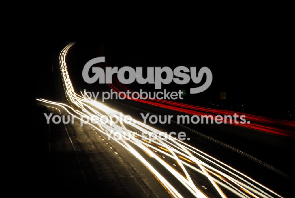

I see a whole lot of long exposure shots where I feel like the shot should be blown out with natural light and frankly, look awful. But for some reason, the street lights and the building lights never seem to effect the overall composition of the shot. My question is how is this achieved? I tried some basic shots on top of a bridge just to see if I understood the concept I was using (I still have a Panasonic Lumix P&S, so I had to use stary night mode to get the long exposure) was working, but the shot was just saturated with the lights from the freeway streetlights...I'm just confused on how to do these shots while still avoiding the craziness of the other ambient lighting...
Thats what the shot turned out as...There wasn't much traffic, but I got the lines. It just seems like it's got so much extra light as opposed to the natural color it really is...I'm not sure...

I kind of like your photo, although it is a bit too bright for my taste. I think your best bet in this type of situation would be to dial in some Exposure Compensation, somewhere along the line of Minus 1.3 to 1.7 f/stops. That much Minus Exposure Comp will darken the overall image,and will help render the lights bright, but will also keep other areas darker; in this shot, the grass and the roadway are simply too bright, so the Minus Exposure Compensation (found on a control or menu usually marked with the symbol +/- ) will force the camera to end the exposure a bit earlier than normal, thus exposing the shot less than it otherwise would. This shot is over-exposed sufficiently that Minus 1`.7 stops would look much better, IMHO. You chose a pretty good vantage point for the shot, and the composition is pretty good actually.
Not a big fan of the white balance or the exposure, but it has potential to be a neat shot I guess. I agree with derrel, a stop and a half or so less would help a lot.
Can you manually set things? For example, i took this shot at an aperture of 25, a 20 second exposure, and iso 100. Granted, the settings do not need to be this extreme. If it is possible to manually set aperture and shutter speed, you should be able to get some pretty awesome shots.
Not with the camera i'm using right now. It's a simple point and shoot that isn't really supposed to be able to do 30 second exposures...it's for stars at night...so it doesn't really give me any options. I'm waiting until I have the cash and upgrading to a dSLR, but until then...i'm stuck with it. I guess my question was is it doable once I have a suitable camera, and from DBJ's repsonce, it is. I just cannot wait til I have my Rebel..I went up to best buy tonight to visit...:)
