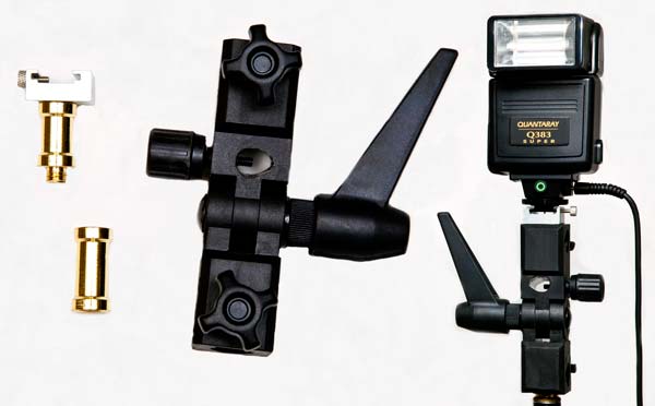

Don't forget you'll need something to connect the flash to the stand.. an umbrella swivel is probably the most useful, I think they are around $15.
If you don't need an umbrella, you could use this adapter to put a flash onto any light stand.

Hm, I was actually assuming I would be using the flash bracket/stand things that come with the Nikon flashes... they have screw mounts on the bottom. Is this a poor assumption on my part?

You could easily do that if all you plan to do is use CLS. However if you are going to use the SB-600 flash (no sync connector) and some kind of wireless solution, then you need a small hotshoe adapter from flashzebra.com and if you are going cactus V2s receivers (becuase they are a little wobbly), its a good move to get them off your stand on top and hanging to the side... more stable and places the flash closer to the center of the umbrella as it is lower.

I had considered also getting some umbrellas, yes... I don't need one that has an adapter for the hotshoe mount, though, do I? I assumed those clamped onto whatever stand I had.
What flash is going on top? SB-800, no, it has a sync connector. SB-600? No choice, you need one, because it has no sync connector. This is only if you are going remote triggering device. With CLS you need nothing except the flash on your camera (D80 and up).

To further complicate matters (lol), you do know that you need a swivel bracket, yes?

To simplyfy:
I'll assume that people who are interested know what a light stand is. ;)
1 - Umbrella. Already touched on in this thread and elsewhere here very recently. If there are any questions, ask away.
2 - Swivel bracket. This holds the flash and umbrella. Permits them to swivel, rotate and change angle to match needs. Usually comes as a separate piece. They come in metal and plastic. Metal lasts forever, and is solid. Plastic is cheaper and unless you start using your lightstands for self-defense, last the life of the amateur's needs.
3 - bolt with 3/8ths screw...Needed to screw hotshoe adapter with sync connectors to the swivel bracket (which comes with a couple of these already). Another one is needed to hold the swivel bracket to the light stand
4 - Hotshoe sync connector adapter. Needed only if your flash doesn't have a sync port (needed for the SB-600... NOT needed if you use the SB-800 or any other flash with a sync socket).
5 - sync cable. Connects flash (or adapter) to your receiver or camera's sync port.
6 - Flash. Err... I have no idea what this does. (I'm kidding!!)
7 - Transmitter. Slides into hotshoe of camera, receives signal from camera that shutter has been pressed, sends the signal wirelessly to receiver (see item #8).
8 - Receiver. Receives signal from transmitter (see item #7) and passes signal through the sync cable to the adapter, into the flash telling it to trigger.
If you are going to use CLS... you will still need:
A lightstand and items #1, #2 and #6.
It can't get any easier! :lol:
