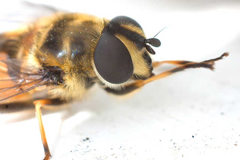

Works fine for me...this is 50mm f1.8 on non-AF macro tubes. I set the aperture on the lens to about f8, then dismount it while holding the DoF preview button which "holds" the aperture in the lens. Then add the tubes. Focussing is done by movement rather than AF anyway. :)
10-4-2012 HoverFly v2 by http://bendthelight.me.uk, on Flickr
