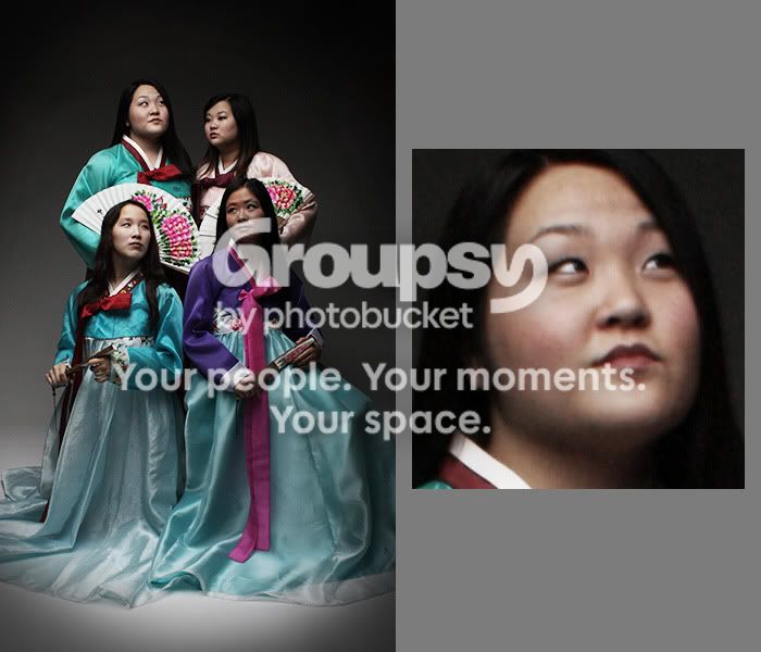

Here is the image. It looks fairly sharp at 100% magnification (cropped down to about seventy percent of its original size), but when I zoom in, all the girl's faces are like the one I isolated. Maybe I am expecting too much from the lens, but I would think it would be sharper than that. (The close up of girl's face is at 100% magnification, it hasn't been resized).
And again, I am shooting with strobes and my camera is at a 1/200th sec. , ISO 200, f/8
Yup, that's what a crummy optical performance looks like. She's in focus--this is not a case of mis-focusing or being outside the depth of field band. That's just bad optics. And what a shame too--the photo is simple and well-lighted. One would expect that at f/8 a lens would be good. Your work deserves better.
You're probably right. F8 should have everything in focus. However, to my old eyes, that collar area looks razor sharp to me. I zoomed in to 200% with my Opera browser and it still looks sharp.

The collar does look sharp, but I think it's the simple nature of that shape at that focal point, with my lens. If that was the target of my focus there is no reason that the face behind would not share that. The flash is firing quickly at f/8, probably somewhere at 1/1000 a sec. It should freeze pretty much anything in acceptable focus.

has a mouse-oer that shows the craptastic image performance of the 18-55 IS--the one sold with a zillion XSi's. The *original* 18-55, the first US model, was absolutely plagued with chromatic aberration. I looked briefly at the dPreview "review" of the 18-55 IS, and they softballed it.
Look at this review,and do the mouse-over, and you will see what I see,and waht many discerning lens afficionados see--LOADS of chromatic aberration that ruins the pictures with an all-over sort of color blur. It's "well-corrected" chromatic aberration, meaning it does not have big, honking, easily-seen fringes of color. But there is an overall "color blur" as one reviewer describes it.
Please compare the Canon 18-55 IS lens with their 17-55 lens at the above mouse-ovr link, and you an see that the difference in the Chromatic Aberration control of the 17-55 is clearly and instantly visible. Look at kkamin's shot--the woman's eyebrow is "almost" resolved, but not quite. The shot he is showing us in *in-focus*. These dPreview softball reviews calling the 18-55's performance "good" in words, but then giving the lens a 7.5 on image quality is ridiculous. No offense, but the 18-55 IS kit lens was computed for 6 to 8.2 megapixel sensors; the XSi has a very densely packed 12.2 megapixel sensor. Off of the center, at f/5.6, the 18-55 is plagued by chromatic aberration,especially at f/5.6.
The bottom line: this lens was FINE on the 8.2 megapixel bodies from several years ago, but this lens is simply NOT good enough for a 12.2 MP sensor. When this lens was tested on the old 350D, it looked good...that was years ago. The 12.2 MP cameras like Rebels XSi and Nikon D2x have small, high-density sensors and they demand top-quality lenses to work well. On the new 7D, with 18 megapixels, I don't think even the 17-55 f/2.8 is good enough at the wide end to shine on that particular sensor...and the kit lens looks like garbage on the 7D. The 28-55 IS lens was never meant to be used on a small,high-density sensor--it's from another "era". Just look at the mouse-over and see: the 18-55 sample there looks just like kkamin's picture does--a vague, general resolution of finer detail, but not the real crystal clarity that the 17-55 delivers. The "well-controlled" chromatic aberration is not obvious--but it subtly ruins many,many images.
