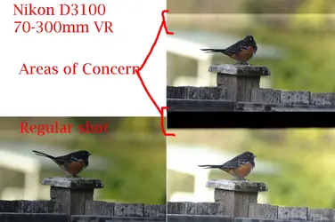

Hello all!
I was just casually shooting until I realized something different that appeared on my images. There's this "black or white strip" that appears on a few of my shots. This never happened before and I am currently shooting with the Nikon D3100 (about 2 years old now) 70-300mm f/4-5.6 (about 6-7 months old). I was wondering if there's a problem with my camera's sensor; I shined a flash light on my sensor and it seems fine, no scratches/dust/etc. I also examined my 70-300mm, nothing seems abnormal, the glass isn't damaged.
This did not occur on all the shots, but did occur quite frequently on other ones. I tried changing my settings, focal length, etc. but it did not seems to affect the problem. When I attached my 35mm f/1.8, the problem did not occur, but still need to look further into this. I don't know, my equipment seems to be in working conditions but that black or white strip is extremely frustrating and wondering if you all had any ideas of this problem :/.
Thanks, it would be much appreciated, I also attached several of the messed up photos.

That first "regular shot" looks like it has the same banding, albeit lighter.
I have no idea, really, what it is, but I imagine others will.
Are all the "problem" photos at a certain focal length, like all zoomed out to 300mm? Are you using flash? Or a hood not designed for that lens? If it doesn't happen with your 35mm, it certainly sounds like something related to that particular lens.

For the first "regular shot" that white blurred line is a fence, but the other ones aren't. But ya, I just tried my 35mm and the same problem occurs. I am not using flash and have Nikon's original hood attached. I noticed that when I'm capturing something of higher contrast (eg. a bulb) it occurs more frequently, but then again the problem still occurs even when capturing non high contrast pictures.

Looks more like a shutter issue.
Agreed. Looks like a shutter problem to me.
Yep.
My Canon 5D started doing this last summer, right before the shutter died...

The D3100 is an entry-level camera body. It was never intended for hard, heavy usage rather, as the name implies, as an entry level camera. To keep costs low many of the internal components are not as robust as they are in the more expensive bodies, and the shutter is one of those components. Shutter lives can be found by doing a Google search but they are really meaningless other than as a yardstick to compare one level of camera body to another. The D3100 has a reported AVERAGE shutter life of about 100,000 actuations but it could still fail at 10 or it could go to 500,000. All things mechanical eventually break, it's a fact of life.
