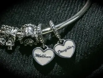

I'm going to order my little ottlite in the mean time I've found a dark background and my ISO was more than 1000. Is this picture a little better ?

The depth of field affects it too. I think it would be better to have the name of the product sharp too so there isn't lettering out of focus that your eyes and brain are trying to read. Look how much of the image is out of focus in the first composition. That to me makes a difference, to have a large part of the image out of focus, and I think it's noticeable here because you see thru the bracelet (if you know what I mean).

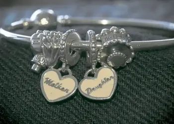

If you have a tripod, or can keep the camera steady with a firm support, there is absolutely no need to go to ISO 1,000; using a tripod and the self-timer delay, it's possible to keep the ISO low, where the dynamic range is widest on the sensor of almost any d-slr camera, and then you can stop the lens down to f/11 or f/13 or f/16 and get pretty much everything into focus, and use a sloooow shutter speed, somewhere between 3/4 second and 3 seconds, depending on the brightness of the lights you have.

In the ones you've posted, I would agree with Vintage snaps on DOF. On my camera for example with a 50mm lens, set f/8 with a distance to subject of 12 inches, only 3/8" total depth would be in focus. Drop to f/1.8 and you only 3/32" in focus, while f/16 that Darell suggested would give you 3/4" . Here's a good online calculator that will help you Online Depth of Field Calculator . Try playing with the numbers and you'll find that the DOF is a function of the lens and the distance from the subject which can also be used to gain DOF.
Darrel gave you some great advice above though he didn't explain why not to use a higher ISO. The higher the ISO the more noise you have in the image, which is not something that's appealing on a product shot.
Some selective sharpening, a mid-tone correction and a square crop does wonders for this image. I might suggest you change your editing preferences to it is OK to edit. Lots can be learned from others.
Sighh!! Okay , I still don't have my ottlite( in the mail ) I did use led light from my cell phone . I did however use 1/10 shutter speed , no flash ,
F 10 and table top tripod one of these photos were self timer. I know that it's still not near what it's suppose to be but I think I'm kinda getting the concept . I can see how lighting effects photo I did try to edit the photo however im not not in the editing stages yet because I have to do some studying on that. I do see now from the original picture I posted and now these , I see the difference between f 2.8 and f 10 little progress on my end with that but still a little blurry . If on a tripod is this the sharpest it would get ?
