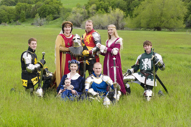

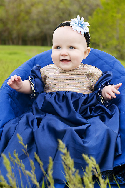

Bah! Don't be sorry! You know, grain of salt.The lighting in #3 is very nice to me. The faces have nice dimension.#2 troubles me the most. This pose I think would have worked much better if you shot more from your left, to get more side view, and in landscape aspect. #6 feels like a classic painting to hang over a fireplace, in the castle. What a fun shoot to do. I like taking pictures of people in costume. Ren faires, civil war reenactments, etc.

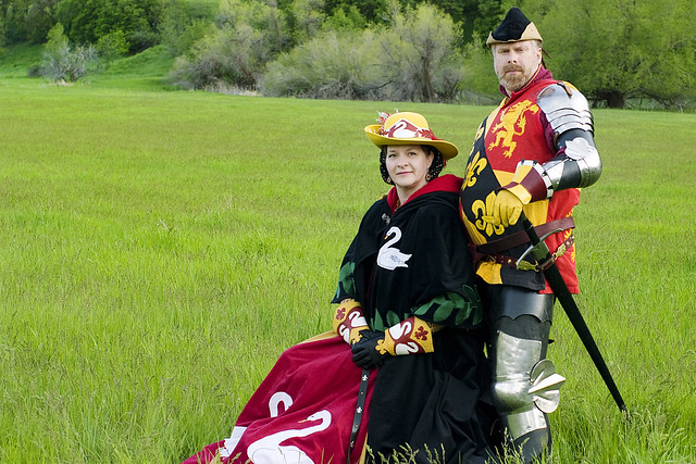

1> Horizontal. Why? It makes absolutely zero sense to frame them this way.
3>The group's eye lines all point to different locations. My money is on "somebody trying to help" with the baby's expression, and distracting the infant, who appears to be amused by one of the other family members standing behind you to your left. The bald, white sky in the upper left is very distracting: a solid, entirely landscape background would have made this photo nicer, I think.

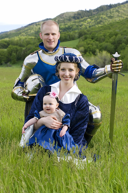

4> Seems kind of far-away-looking, and the camera height seems too high. I do not like the horizon line running through the heads of the back people. The far-away-looking thing looks to me to be from a relatively short focal length that is giving a LOT of depth of field, all the way back to the modern, wire fence line in the back right. I'd loved to have seen this shot with a 180mm or 300mm from farther back, with the backdrop "suppressed" more. JUst seems framed awfully loosely, and with more depth of field than optimal to put the emphasis on the people.

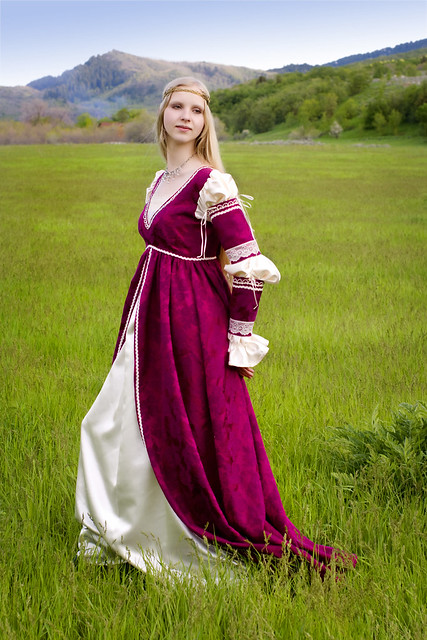

5> The baby, with an entirely landscape backdrop...I wish shot #4 above had been handled the same way, without the bald white sky. In this photo, of the baby, there are only two main planes: near, and far. With #4 there is near, far, and Infinity, three planes of distance. Pretty serviceable shot. BIG baby, framed just right.
6> Suitably demure, the young maiden is posed well, and her expression is excellent. Solid shot. Posed better than her brother in #2, whose sword is sort of sticking to the side of his head, and who is "lost" by being seated right on his butt in the grass, even though there's a suitable log nearby, thus losing a lot of the charm of his costuming.

1 - I actually like the horizontal framing, but I think the crop is too tight, especially on the top of his head. I agree with Derrel that the greens are pretty much all way out of whack. My guess is that you significantly warmed up these photos, and that pushed the greens to far towards yellow/orange. I would go in and selectively push the green back towards blue a good bit, and return them to a normal shade of green, instead of nuclear yellow/green. They could also stand to be a fair bit darker.
2 - Same for the greens. Just feels somewhat random for me. And he's totally center-punched.
3 - Looks nice. Lighting is nice. Same again for the greens, same again for the center-punch. I with the skyline wasn't right above his head, should have allowed for more space. Basically feels like a tight crop to me, even though it's not the edge of the frame. Wish the baby was looking, but we all know how that goes.
4 - Same for the greens, same for the positioning. the big problem here is that the horizon line is going straight through 3 people heads. That's super distracting to me. Prominent lines like that need to be treated just like cropping lines, and positions accordingly, i.e., not through peoples' heads.
5 - Greens. Crop. Horizon line, this time coming right out of her off camera eyeline. Makes it very hard to keep your eyes in the frame, instead of following her gaze and the leading line right out of the frame. Also, not a fan of the out of focus grass in the foreground.
