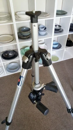

I have a Manfrotto 141rc tripod and I was wondering if anyone knew of a lateral side arm that I could buy that would attach to it please?

Your query is confusing because a Manfrotto 141 RC is just a 3-way head, not a tripod.
Being a 3-way head it won't accept a lateral arm.
What make/model tripod legs do you have?
I was hoping I would be able to attach a lateral arm to this 3 way head in some way? Sticker on tripod legs say manfrotto cruppo.

Thanks. I am leaning toward this plus a sandbag:
Manfrotto 131DB Accessory Arm
I just need to make sure it will attach to the tripod head once flipped - see image.
