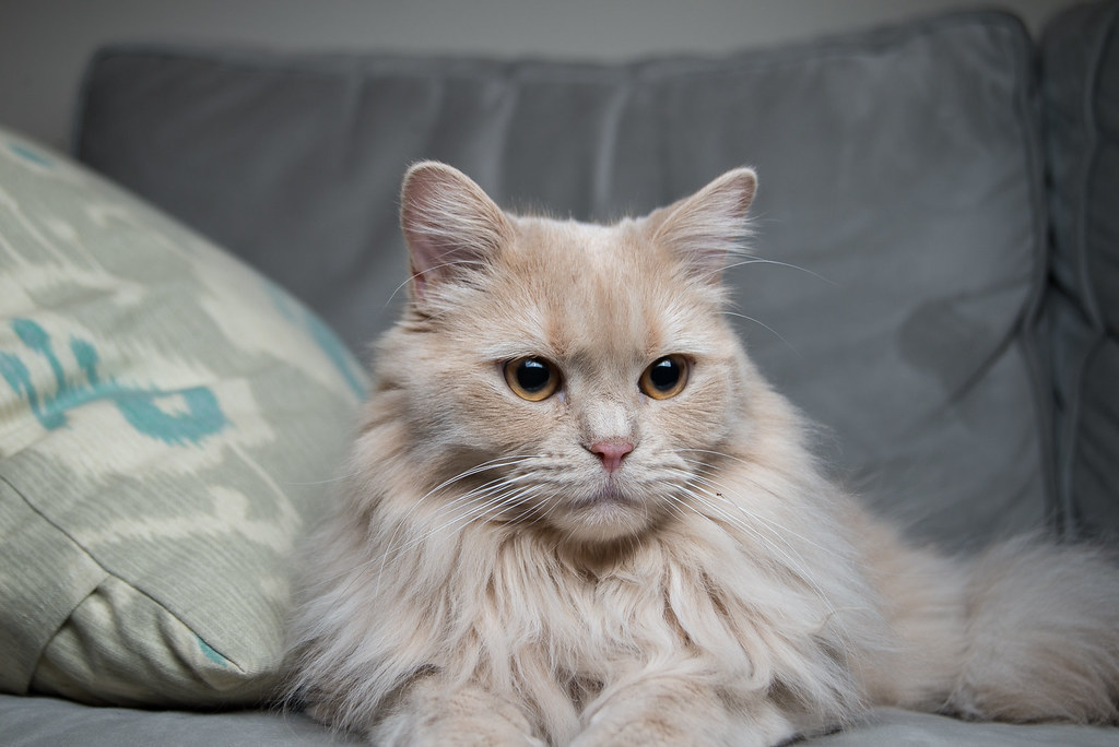

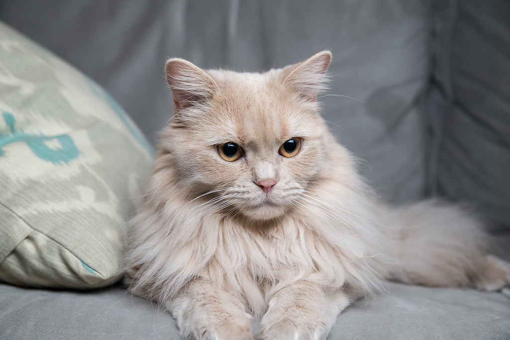

Here's a comparison against my Tamron 24-70mm 2.8 VC both at 50mm, 1/125, f/5.6, iso 500.
The Tamron:
Cats 038-1 by The Braineack, on Flickr
The Quantaray:
Cats 040-2 by The Braineack, on Flickr
Hard to see it here.

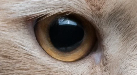

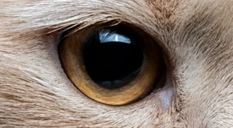

But look at it 2:1:
pookie_eye_test_tamron by The Braineack, on Flickr
pookie_eye_test_quant by The Braineack, on Flickr
Just shooting things around the house provided really abysmal results. Nothing ever looks "in focus" everything is soft, even the colors are soft, there's awful chromatic aberration, and if there's any direct light in the shot it flares and clouds up the blacks.
But, had I never zoomed in, it's hard to tell ;)

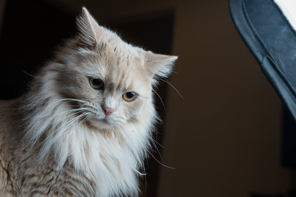

Here's what I was talking about when I said it clouded up in light:
Tamron:
Cats 050-2 by The Braineack, on Flickr
Quantaray:
Cats 049-1 by The Braineack, on Flickr
Most of the images I took with it had that glazed look to it.

I was surprised to see the softness as the first two shots the Quantaray looks to have a touch more contrast so I was expecting it to be fairly sharp. There are a few sources for the softness;
1) Resolution - higher MP sensors require higher grade glass to perform well; especially when comparing 100% crops.
2) Lens Fungus - have you checked inside - you might have fungus which could also be causing the clouding effect. Similarly you might have a film on your lens rear or front optics (clean them) or internally they might have a dust film (fairly thick). It could also be worn off coatings.
Having a 24MP sensor is probably more than the lens can resolve, so that's probably why it's showing up soft. But yeah, I've never quite understood the lens:sensor rendering ratio and reading about the Nyquist frequency and all the technical stuff just hurts my head.
I just cleaned the front glass element with microfiber cloth. The lens itself had never been removed from the body since day one and the rear element still looked good so I left it alone. I couldn't see fungus if there was and the coating still looked good to me; I was actually impressed that as a teenager I kept it in such good shape :)

I think that the Quantary is actually pretty sharp, for some definition of the word sharp. It resolves the same things, but without as much contrast, so the MTF certainly doesn't look as good. For low contrast features, it's going to go to mud a lot faster, but for high contrast stuff like fur it's not so bad. It's also pretty flarey, which is related.
Before:
After a mild curves adjustment to push the blacks down some and the highlights up slightly, and then a mild/moderate unsharp mask:
The Quantary has difference rendering characteristics, and in some ways it's not so good, but mainly the pictures it makes just need to have handled a bit differently.
It could be as simple as a slight focusing error on the Quantaray shot. At such close range, being "off" by 3/8 of an inch would be enough to make the individual hairs around the eye not be sharp.
As to the haze...that looks like what is often called "veiling glare", and that is an optical defect that MANY zoom lenses suffer from, especially when shot in darker environments and toward brighter light sources. My older 1999-era Tokina ATX 28-80 f/2.8 AT-X Pro (lol...what a name) suffered terribly from the same issue...I called it "Der Flaremeister".
