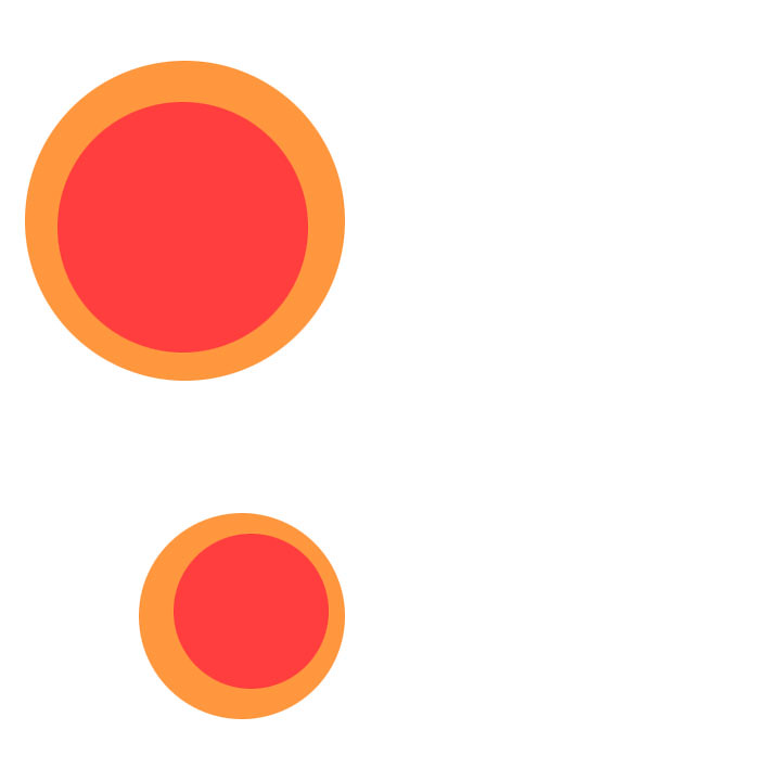

Okay made a 2 second picture to maybe help my question
The circle on the top represents the 80 mm lens looking directly at you at F2. The circle on bottom represents the 40 mm lens looking directly at you at F2. The red part (the lens aperture) is larger in the larger diameter lens so would that let in more light than the smaller lens opening?
Maybe that clears up my question.
OK - I get your question now. I think, lol.
I assume that when you said 80mm diameter you really meant a focal length of 80mm...? If you just mean the filter size, that doesn't necessarily mean anything.
OK, so assuming you have 2 lenses - one with a focal length of 80mm, the other with a focal length of 40mm...
At f/2 (on both lenses) although the actual size of the opening in the two apertures would be different, they would let the same amount of light through.
With both at f/2, the 80mm lens would have an aperture diameter of 40mm (f/2= the length of the lens divided by 2). The 40mm lens would have an aperture diameter of 20mm.
Even though the aperture diameters are different, they let in the same amount of light because the length of the lens is a factor too.
If you are just talking about the physical size of the lens (not the focal length), then there's no way to tell. You would have to know the focal length.
But...say you have two 85mm lenses. Say, the Canon 85mm f/1.8 and the 85mm f/1.2 L. The 1.2 version is physically much larger. But, if you set them both to f/2, since they are the same focal length, the same amount of light would be coming through.
