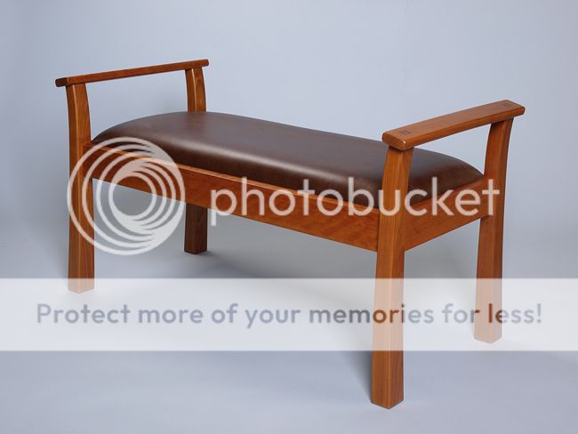

Hi Remi,
You are going to get the best results with a typical three light set up (main, fill, background) and a 9' paper backdrop.
I worked with continuous lights for a while and decided to move up to strobes. FYI my continuous light set up cost me ~ $500. It was worth it just for the experience and I still use them once in a while for small product shots.
Shooting my own work I prefer a "focus gray" background. I'm using 2 x Alien Bees B1600/640 w/s and 2 x Cowboy Studio 200 w/s lights.
The Cowboy Studio lights are being phased out :sexywink:
Here's an example..
Your in situ shots definitely would benefit from more light and a little less clutter ;)
I should mention that I'm partial to a studio/backdrop image, that is what has been required for jurying/grant proposals/portfolio/magazines...
Cheers, Don
