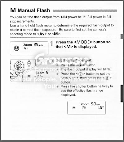

Using a 430EX (Canon)...how do you determine 1/8th or 1/16th on the flash screen? I had this problem outside the other day. Also where would you point the flash if it was in the hot shoe....also, with or without diffuser??
Freedbaby
Page 19 of your 430EX manual, Freed...

Thank you VERY much, that was the most helpful flash response I have ever gotten. I listened to two of the videos already on the ABBC website and they were very helpful. I didnt realize also that the flash had to be in manual....never been there before.
