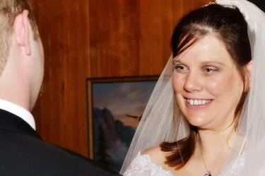

Ok, so I have been doing pictures and getting really busy with my on-the-side family photography business, and friends and clients have been asking me to do their weddings.
I've done outdoor weddings and I am confident about my work in that setting (lots of light).
However.. I've tackled a couple here recently that were indoors for friends and I have had some issues with the low-light conditions in the churches/venues. I need advise on how to get good pictures, without killing the atmosphere of being in a low-light/romantic venue. I've just been lighting up my pictures with unflattering flashes in order to shoot between 400-800 ISO.
So I'm looking for help. I know these aren't good.. :( I want to get better though so advice would be greatly appreciated!!

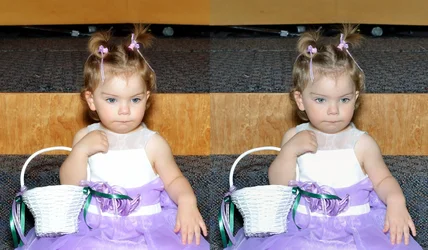

#1 The littlegirl on the ground is the bride and grooms daughter.

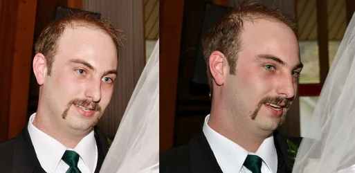

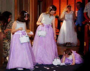

#2 she was very concerned about the petals being left beind by the other two flower girls in front of her.

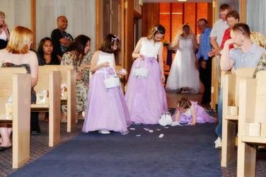

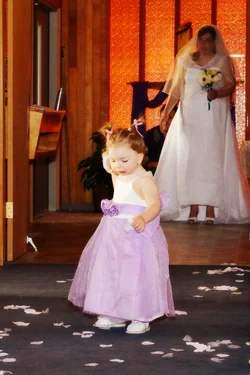

#3 needs to be cropped differently. but lighting-wise...

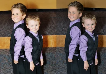

#4 I needed to get a better angle for this over-the-shoulder shot, but lighting wise...

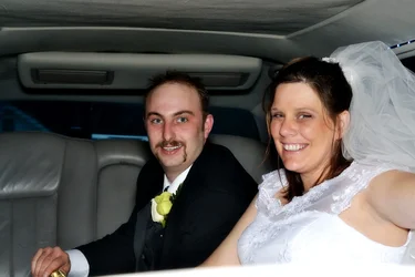

#5 This shot was when the were leaving in the limo. I only had a minute.. So yes, I flashed then *cringe* What I would have liked to do was catch the dimly-lit romantic feel of the inside of the limo. It was lit all around the top with small led lights, but all I was getting was underexposed images until I just put my flash on them (with a diffuser, but still.. yikes).
So ok, there you guys go. please help me. Is bumping up ISO the only way to get the look I want?

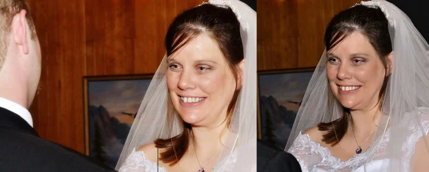

The flash really hurts, blasting all the tone, etc. but with some effort I think you can make these better by cropping closer, lower contrast, fixing wb, etc.
There isn't much intimacy in these shots
Here is #4 after doing all the above and putting through Portrait Pro 10

I've been thinking about this ever since I posted these pictures and I think that I may have done damage to the pictures with my post work. I processed them the same way I process my outside pictures to try to get the same light&bright feel. The problem, of course, is that I wasn't outside doing a portrait session with little tots.. I was in a dimly lit church during a wedding ceremony.
Your edit made everything click in my head. I'm going to get back into my original files and start over. I'll re-post the 2nd set and see what you all think. :)
As always.. Thank you so much for your advice/critiques and suggestions to help me not suck so much! lol
OK, so I went back to my originals and started over. Keeping in mind, less is more when it came to editing, and I think these re-edits/un-edits are much better.
Not the best wedding pictures ever, but a vast improvement from my previous edits. Here are a few of the before and afters. Better? Worse?
#1 (These aren't the same exact picture, but very similar)
#2
#3
#4
