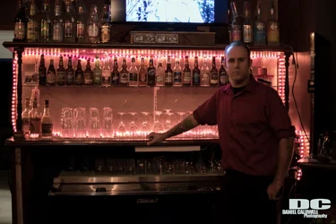

I use mine mainly when the light is low, a dark barroom, when the sun is setting and stuff like that. here is a photo I took from about 5 or 6 feet away at 1.8 with my 35mm lens. as you can see I focused behind the bartender and he is slightly out of focus. the person was standing directly in front of the stuff in the backgorund, If I would have had my focus point on him he would have been in focus but that was the first time I shot with that lens..

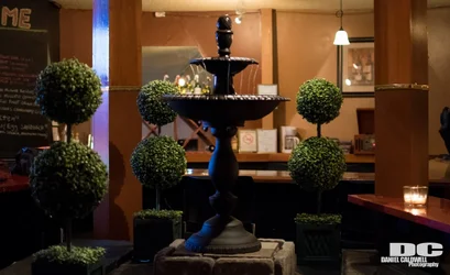

here are a few other pics that I took at f/1.8 where I was a little further away, the one of the fountian I was probably about 7 feet away, that is just a guess. the entrance I would guess I was about 10-15 feet away.
