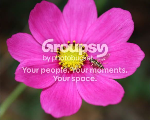

Will it be able to auto focus? I'm so new to all of this...I always use auto mode. When my 3 year old gets older I will have more time to learn...right now I just want to be able to get up close with some bugs & flowers!!! It says I can't post an attachment?? So does that mean I can't put any pictures on here? I have a canon rebel xsi 12.2 mp with a 18-55 mm IS lens and a 55-250 IS lens. Which extension would be best for me? Thank you all so much...I feel like you are all so professional I hate to even be asking such stupid questions.
this is as close as I can get???
1st off Avoid the canon extensio tubes - DON't GET THEM ;)
Simply put all they are is an extension with no optical components (no glass) and electrical contacts and the canon prices on them are very high. Instead get yourself a set of Kenko AF extension tubes for canon (check that last part as they make stuff for other brands as well)(make sure they are the AF sort). Then you will get a set of 3 tubes for about the same price as 1 canon tube and since they only add air the optical quality is exactly the same for both.
Typically you use tubes with shorter focal range lenses, since the rough math is that if you equal your focal length with tube length you will get a boost to around 1:1 macro - so 50mm or tubes for a 50mm lens for example. Clearly you can see that with longer lenses, whilst you will get an increase in magnification it won't be as great unless you start adding a lot of tubes.
I would also recomend looking at the Raynox DCR 250 it is one of these macro diopters - so it is a lens (glass) which attaches onto the front of your current lens by using the filter thread. It works the same way as tubes, but by using glass instead of moving the lens away from the camera.
The raynox range have become very popular with macro shooters as they are surprising high quality, for little cost and their image quliaty can be very close to the same effects using tubes (noting that tubes do cause some image degradatin, but not very much unless you are adding silly amounts).
