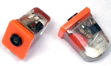

I just bought the Gadget Infinity triggers (also known as poverty wizards). I've used the same weak batteries that came with the units and in close to 500 shots now, I have not had ONE misfire yet. I do expect them to happen, but since I am not getting paid for my pictures, I sure won't mind the odd misfire.
Let me put it this way... if you are a professional photographer, you have NO reason to use anything but Pocket Wizards or perhaps the up and coming top of the line Radio Poppers.
The GI (Gadget Infinity transmitter/receiver) units are DIRT cheap and the only thing downing them are 4 things:
- They have a meager 30 foot range
- They are built flimsy
- The receivers use expensive proprietary non-rechargeable batteries
- They cannot sync much above 1/250th of a second
Well... my rebuttal is:
- With 2 minutes work, I increased the range of my setup from 30 feet to (max range unmeasured yet, but I will try it out tomorrow) at least 120 feet.
- Built flimsy? What do you want for 35 dollars? If a receiver breaks, get another one for 18 dollars! At this price range, buy double what you need and they will far outlast what you want and still be 1/20th of the price of a Pocket Wizard. In fact, I bought 1 transmitter and *5* receivers for substantially less than a SINGLE Pocket Wizard!
- The proprietary batteries in the receiver... This is another EXTREMELY simple thing to address with a 60 cent external enclosed battery case, 2 pieces of velcro and a spot of solder. Now they last longer, use CHEAP rechargeable batteries and last forever.
- The standard sync speeds... My camera's maximum sync speed is 1/250th, but I have had a few 1/320th shots that came out clearly, even though they were not supposed to... In short, I do not need more that 1/250, as most do not either. If I need a picture with a 1/8000th shutter speed AND a flash, Nikon's wireless has me covered.

Link to my blog on the GIs. I'll add a few pics and comments about distance after I test out the distance as accurately as I can.

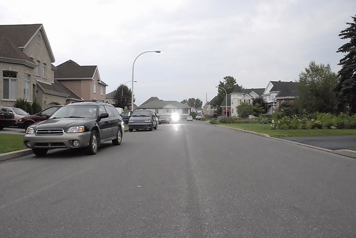

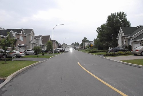

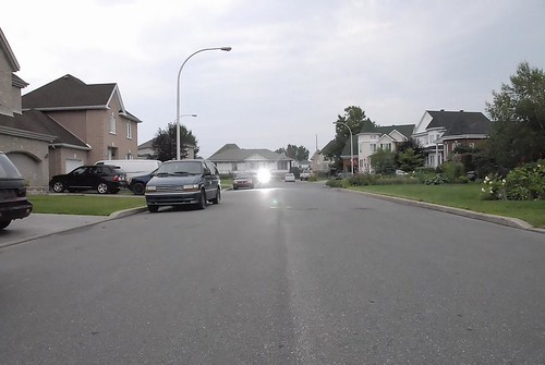

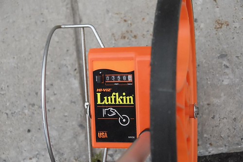

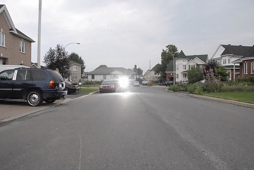

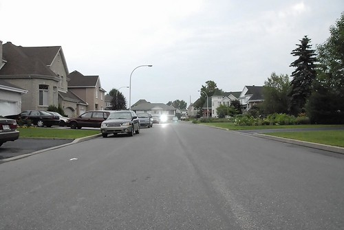

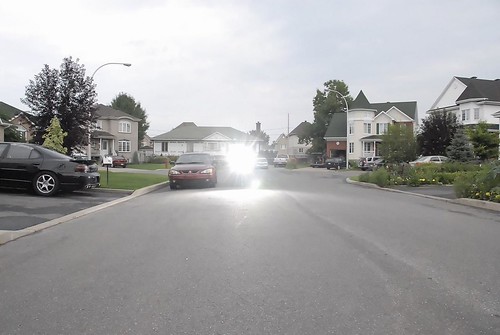

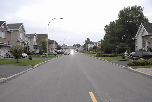

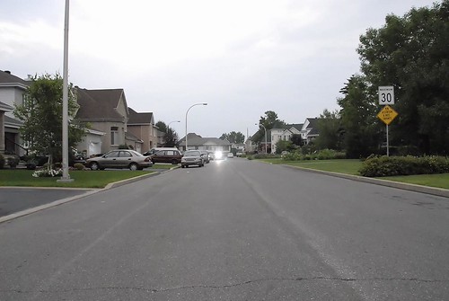

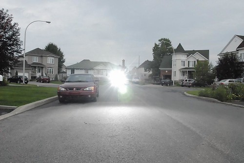

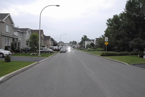

Ok, I had to do it... I went and did some measurements. Let me say that the results were NOT what I expected. I set a small minipod out on my street and placed the the modified receiver (to use 2 X AA rechargeable batteries), on it with the SB-600 at 1/4 power on top of it.
I had set in my mind that for a distance to be successful, it had to take 3 consecutive pictures from a standing, kneeling and above my head positions. Any 2 consecutive misfires would define it as a failed distance and 3 consecutive misfires a complete failure.
I popped the shutter once as a test, it worked... so off I went walking:
30 Feet:
50 feet:
75 feet:
100 feet:
125 feet:
150 feet:
175 feet:
200 feet:
225 feet:
250 feet:
275 feet:
300 feet:
At 358 feet, I could go no further again, else stand on someone's front yard! :
The important thing... were there any misfires? Yes, ONE... at the 358 foot mark. I also took pictures of all measurements where my back was to the flash, I was bent forward and took pics of the measuring wheel. EVERY picture that I took in this position set off the flash, even at the 358 foot distance:
I wanted to make sure that the distance we were walking away was the same back as we stopped going there (obviously), but measured the distance in one shot walking back... avoiding any potential slips or miscalculations.
It was 1/10th of a foot more coming back... close enough:
