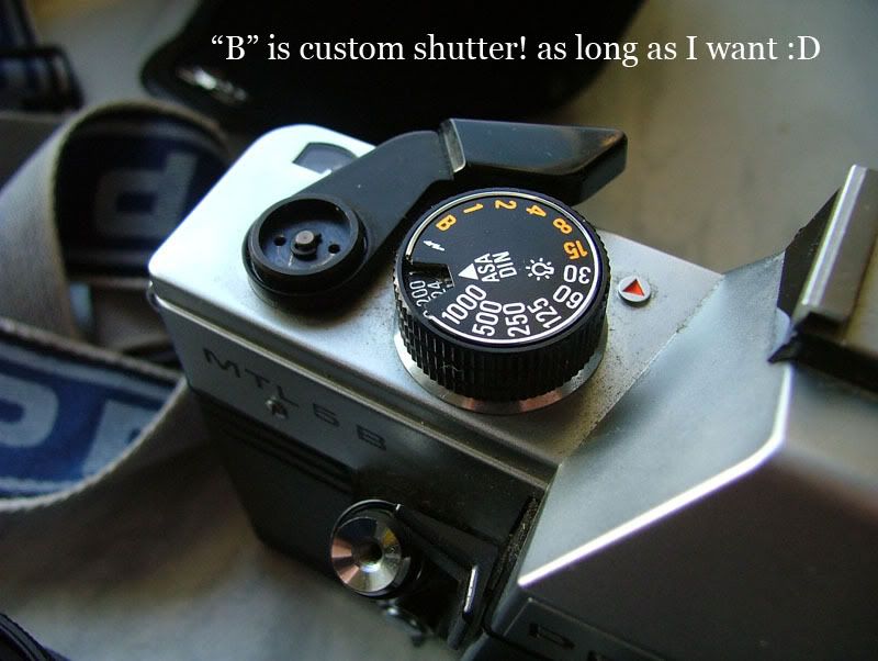

Here she is... Praktica MTL 5B.. made from 85 to 89 I think.. that doesn't matter too much though, unlike digi cams age doesn't matter, as it's the film roll that depends on the picture quality.
As you can see there are two lenses there. How can I tell what they are? I'm pretty sure the smaller one is just a 35mm, but how can I find out the other one? It doesn't say on it whether it's a 200mm or whatever, but it's pretty tight. I found an old manual for the older model here, so I'm gonna use it to figure out all the numbers and that on the lenses.
I'd have put this into the film photography forum, but I figured that the question was about lenses, thus could fit in both digi and film, or here.
And what does the "B" stand for. It gives me unlimited shutter open time, which is what I've dreamt for, but I don't know what the B stands for.
Thanks.

B stands for bulb.
Look at the end of the lenses. From the photo I can just barely read the end of the smaller lens. Looks like it says 1.8/50, which means it's a 50mm f/1.8

'Bulb' traces back to the old days of photography when a shutter was sometimes actuated by a squeeze-bulb connected by tubing to a cylinder/piston mechanism. Exposures in seconds were the rule for interior studio exposures. When you squeezed the bulb, the shutter opened. When you released the pressure, the shutter closed. The 'B' designation stuck.

I believe your camera has the M42 screw mount. If your lenses simply screw into the camera, that's it. There are a zillion lenses available in a huge number of focal lengths in the M42 mount. Lenses with other types of fittings will not work without some sort of adapter, if at all.
Lenses for Pentax Spotmatics are M42.

The ISO setting just tells the light meter how fast the film is so it can suggest a good exposure. If you are setting the shutter speed and lens opening by hand, the ISO setting has no effect other than that.
Setting the exposure of an ISO 200 film in accordance with an ISO 12 exposure reading will lead to gross overexposure. It's a 4 stop error -- 16 times too much light.
