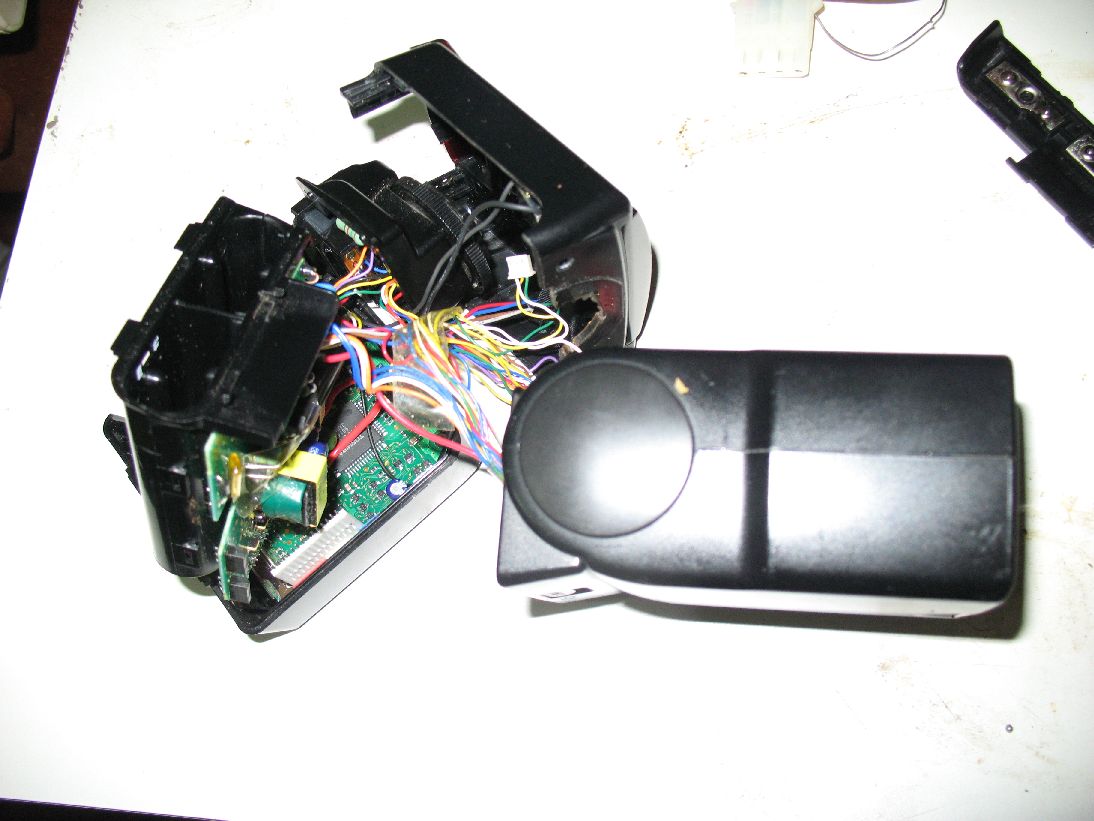

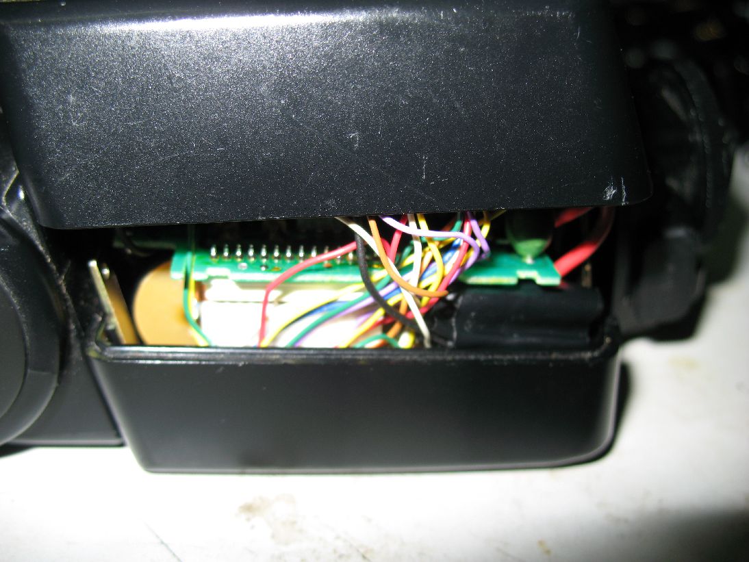

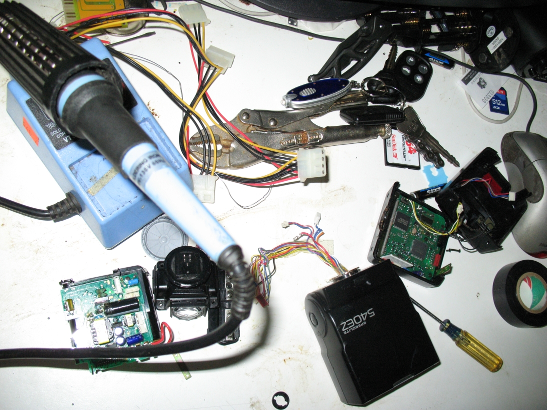

so my flash I bought like 3 days ago stopped working. hmmmm. so I pulled it apart and found a broken battery contact. didn't think to grab the camera until i had it all apart. I re-soldered a wire from the broken contact to the PCB. (red wire at the bottom left)

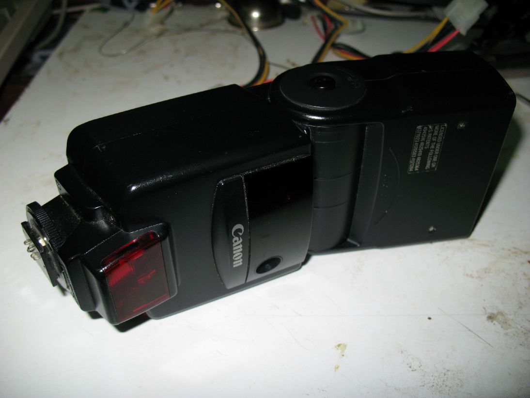

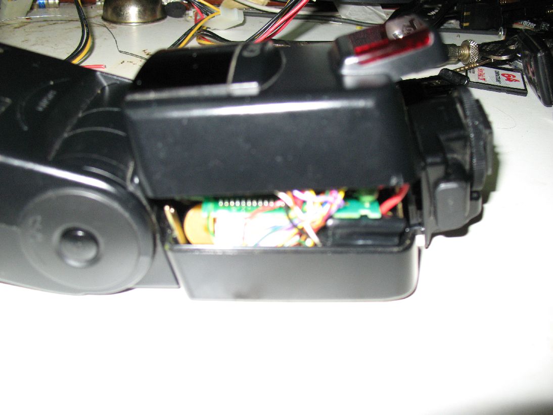

almost got it back together, lining up everything. the black tape roll on the right of the flash inside is to keep the broklen contact in place, it rests between the wall of the flash and the contact keeping it in place.

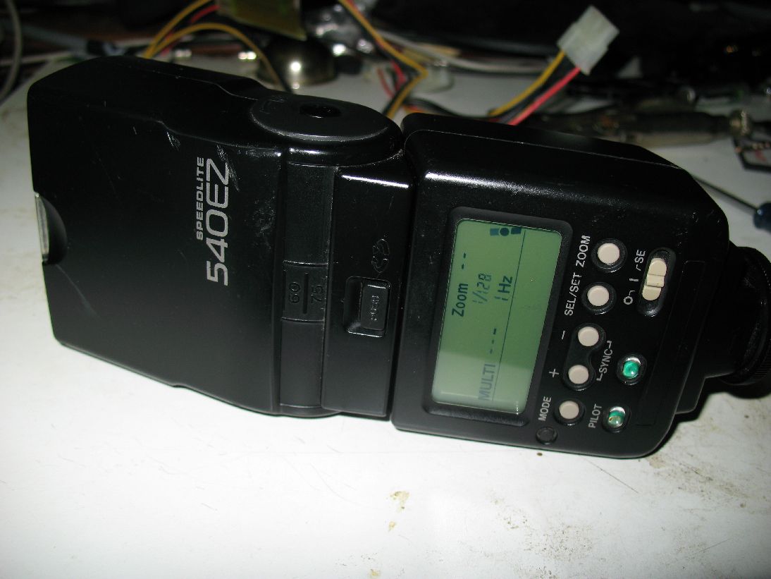

and if you do it right, it looks like this. :thumbup:
