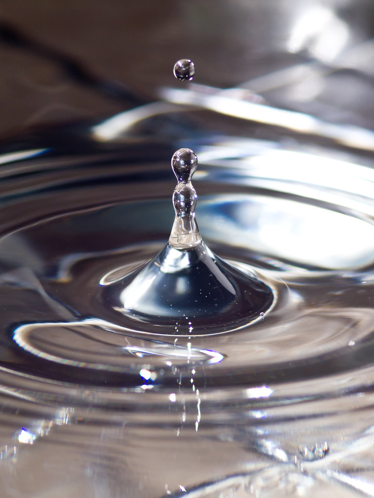

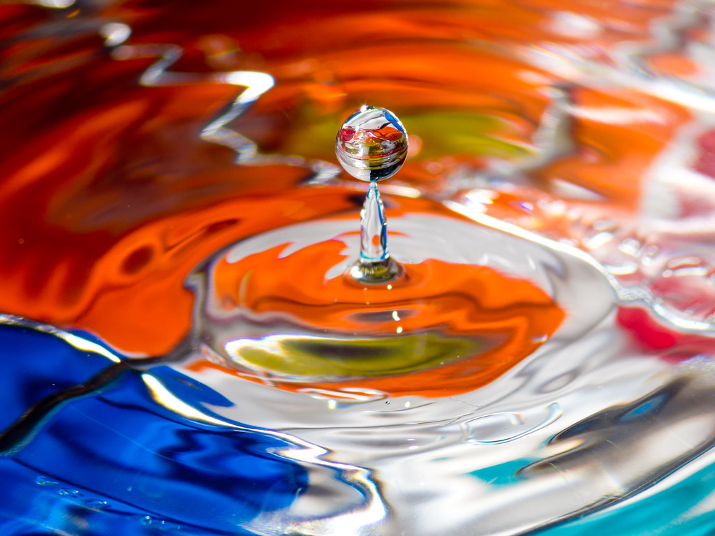

I've been meaning to try this out for several years but just now getting to it. Sure filled an otherwise boring Sunday evening with some fun behind the camera.

Yeah my first attempt at water drops didn't turn out this well. Looking forward to getting some more time in the near future to try again. Great shots. How many shots did you take to get these two?
The camera I selected has a very slow FPS and small buffer, so it took a lot of shots to get it right. I have a modified Sunpak TR-PAK II + 444D powered by those large Ni-MH batteries that were originally used for electric RC cars so the flash has no problems keeping up. (Its from my "strobist" kit). The flash was bounced off a white foam board at 45 degree angle and 90 degrees from the off camera flash. Of course, everything supported by either tripods or umbrella stands. The final setup was a clear Pyrex glass baking dish, on shiny metal grill (you can see it in the 1st), and raised an inch off the table with some books. This setup allowed me to side various things underneath for different effects. The 1st photo taken with one of my kid's coloring books slid underneath. The 2nd was just a darker brown butcher paper but with some food dye dropped in.
I believe I took about 400+ shots to get it right. It took about another 100 or so shots to experiment with various configurations to see which gave me the best results. I also noticed you can experiment with multiple light sources as well....

Love both pictures in set #1. Picture#1 just blew me away. The colors in combination of the drops is just amazing. And after reading how many shots, time, and experimentation it took, it's even more amazing.
