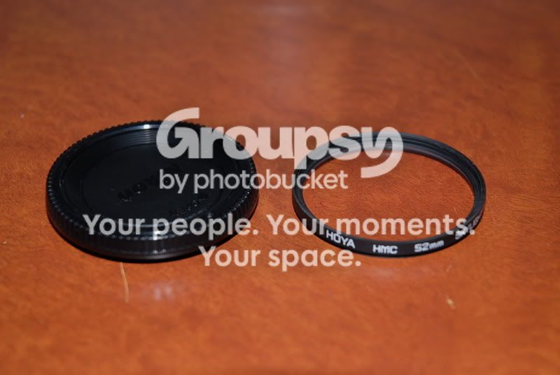

Monster check out this:
The one on the left is the cover for sensor / camera. It is what gets mounted on your camera where you don't have lens attached, it has the same thread as the back of the lens (Fmount for Nikon). The one to the right is a filter. (UV 52mm in this case). If you don't know what that is I suggest you research and buy one. A UV filter is standard amongst pretty much everyone on this forum since it does nothing and protects the front of the lens in the process.
I think you can see where I am going with this. Cut out the center of the cover, and glue the filter thread up to the outside. What you then have is something with a lens thread on one side, and a camera thread on the other. Can be made for <$15. Then you can simply screw your lens into the filter/cover and screw the cover into the camera :)
That way you can use both hands to keep the camera steady, it is easier to get the picture in focus since the lens doesn't move independently from the camera, and you are also preventing dust getting into the sensor.
