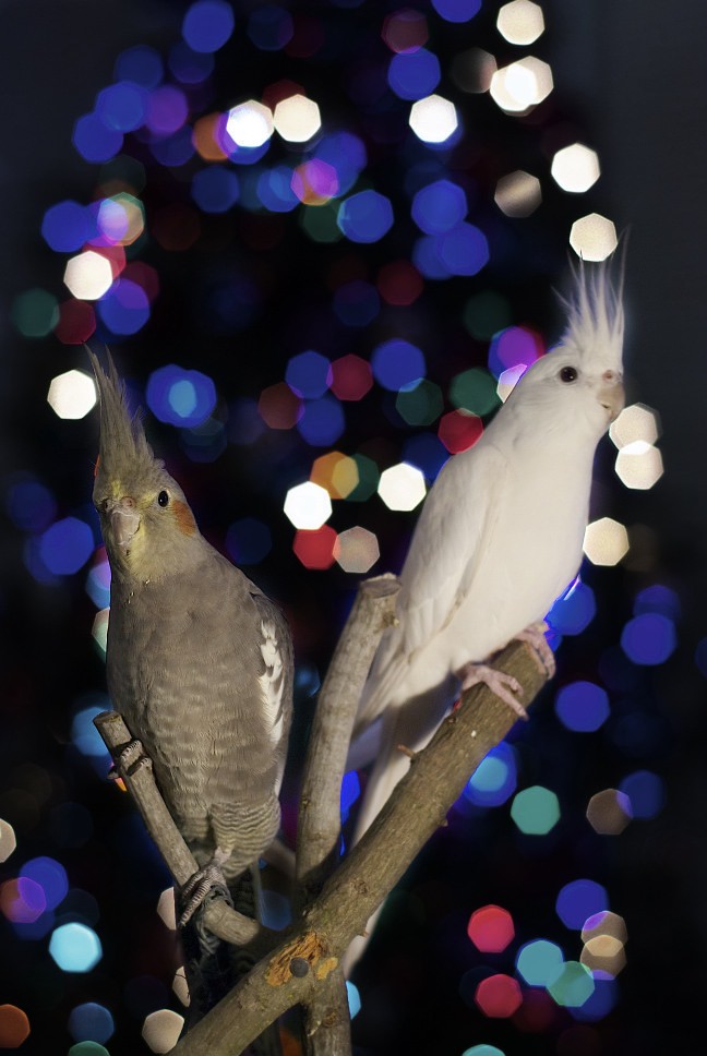

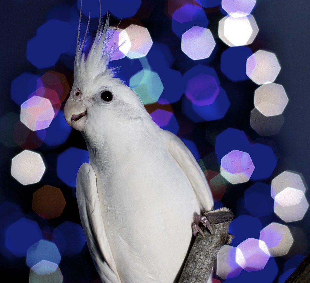

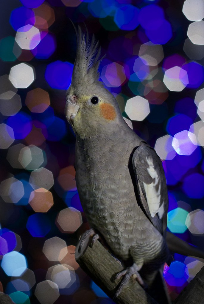

My hand at the "holiday bokeh" for C&C
It's very pronounced but the bokeh itself isn't appealing quality due to the lens's quality, nothing you can do about that. The last shot could use a little light camera right. Cool shots.
I like them but they're too cold for me. Christmas time is all about warm and fuzzy and these are anything but warm. All the white and blue lights say Hanukkah much more than Christmas. Did you aim for hexagonal bokeh? If you wanted circles, you should have shot wide open. Just my humble opinion.
Prolly just comes from a cheaper lens - more than likely a 50 1.8?
why isn't the bokeh more round, what lens you using?
I think you could brighten them both and as mentioned warm them up just a tad.

I quite like these shots, though as mentioned they don't really have a "holiday"-type feel to them because of the cool colors. If that's what you're trying to do, I would suggest using warmer Christmas lights (I can tell the ones you used are those newfangled LED ones, look for the warmer incandescent ones), and maybe letting in a little more ambient light. Though to do that might require a slower shutter speed, and I don't know how slow you'd be able to manage with cockatiels. The seven-sided shape of the lights doesn't bother me. Cool shots!

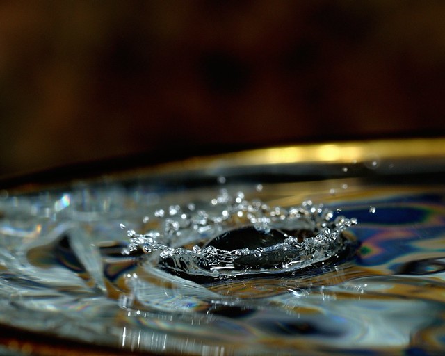

Not sure if the round OOF highlights are from the shape of the water droplets or if this lens keeps OOF highlights round at nearly every aperture. Shot at F22. 9 tokina 100mm f2.8 macro with 9 rounded blades.

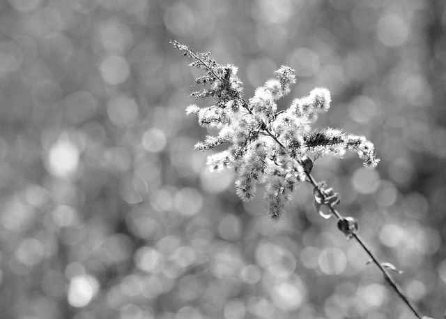

Depends on the lens construction. Here is one at F4.5 with my tokina 100mm f2.8 macro. It has 9 rounded blades.

It is not matter of wide or not. When is fully open, no matter how wide is, blades are open, so they not appear into the lens hole (to be clear). When you start to close, they... close the hole with their shape. If blades are rounded, or many, then you still will see round bokeh.
