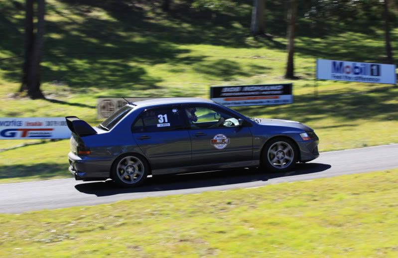

I have only shot at two events so far, and my biggest problem is that due to the movement of the vehicle, my pictures dont come out very sharp.
the only way i can have them sharp is to have a very fast shutter speed, but this means the cars dont look as though they are moving due to the wheels not being blurred as is the case with the slower shutter speed.
so my question is, how do i accomplish the sharpness of this:
http://img63.imageshack.us/img63/745/stevesskylinebytravishi.jpg
My shots currently look something like this: i understand the lighting has to do with it, but i could only shoot from the places i was given.
As you can see, iv tried to slow the shutter down to get the wheel spinning effect, but it return i get a very unsharp vehicle.

i would use a shutter speed of around 1/60 on shutter priority in af-c / spot meetering and select a point for focus

I would say not, it is probably taken at about 1/40 from a car driving parallel, but it is not a great shot not that sharp
Set your camera to shutter priority at about 1/100 elbows tight to your side follow the car (don't shoot straight away) don't move the camera up or down and as smooth as possible follow through after the shot, once you get the hang of it you can start to drop your shutter speed
Here's one shot at 1/30

If you're looking to get that effect, as sort of mentioned above, practice panning the camera. Follow a subject keeping it in the frame. As you get better with it, start using the focus pressed halfway. The idea is to try and keep the subject in the same parts of the frame as you pan, AND the car moves in the same direction. The end result is a motion blurred background with an in focus subject.
As you get better, slowly drop shutter speeds till you get the effect you're going for.
Action photographers use this technique all the time.
Forgot to mention back button focus is your friend for these type of shots
thanks for the advise.
using a single leg tripod would be ideal for this yes? to keep the camera steady?
and any particular metering i should be using for it?
LOVE number 1. Great shot. And who doesnt like an EVO...
