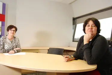

here's a few shot I took today, but Im missing my models....Its better than I tought but still needs work...
Any advices on my photos will be welcome! :)

I'd have the booklet/folder open so it looks like she's looking at something instead of staring at the cover. The artwork in the background cut off that way just makes it look like something hanging there at an odd angle. I might have framed that shot vertically.
Maybe try different vantage points and see how the background looks before you get people in the picture. Go early before the scheduled portrait time.
Too much space in the second one - if you got in closer and got them both looking at the camera that would be better. The overall color and quality is nice.
I'm not sure what you mean by taking photos in movement.
Yes, to Sharon's points above.
In addition, we often hear about "lines" in photography (or any of the visual arts). We all know about: S and C curves, and leading lines, but there are also psychological lines. That's the line between a subject's eyes and what they're looking at. As a viewer, we try to associate the attitudes, feelings or beliefs of the subject to the object that they're looking at.
In the second picture, they could both look at the camera, but for "set" pieces like this I usually have them engaging with each other. In an annual report, we want to convey that the workers are happy, engaged and solving the world's problems (or at least making my stock value go up), and not stopping to look at the camera and get pictures taken. Of course, there are plenty of exceptions to that rule.
In contrast, for executive, officer or director headshots, I almost always have them look directly at the camera. Because they're not looking at me, they're looking at the investor. Direct eye contact conveys trust and integrity. Looking off to the side says that I'm looking for ways to hide something about money from you.
And that motion thing? Yeah, I didn't quite get that one either.
However, when shooting a group of workers (for example, around a table) I've intentionally had them moving a hand towards whatever they're working on to show action. Getting that blur just right requires the perfect balance of ambient vs. flash and using rear-curtain sync that's probably beyond what we can cover here.

The first has good light, but your model should be looking at the camera and holding her folder. You have missed the top of her head.
The second photograph is too much light. Shoot more toward the wall, not the window. Get closer to your subjects to fill the frame.
