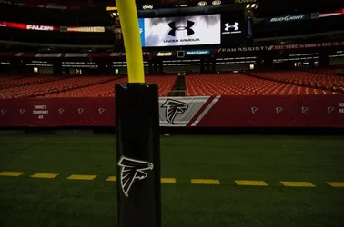

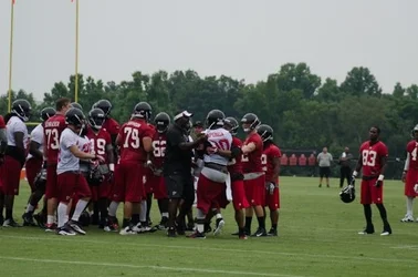

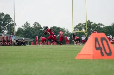

the pictures at camp. these were shot on around F5. (if I go to F3 or lower, you cannot get everything in focus that you want). ISO had to bite the bullet and move up to 500. And that was to get my shutter speed up to 1,000.
- It is very important to have the fastest shutter speed. I wish I could have 4,000 with my ISO at 100 and my F around 4.5-7
- It was crazy bright that day. so it makes no sense why I had to do those setting like that. It was 4:00 and just a couple clouds in the sky, but they were casting no shadows.
- I forgot to change my metering. but it was set to "spot".

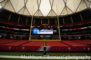

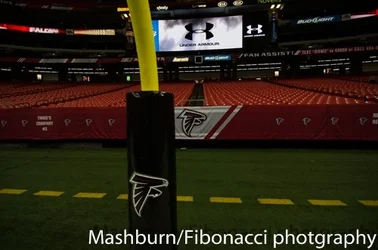

The pictures at the dome I had to pull my F to the lowest it would go 1.8, ISO 100 (I hate pushing my ISO up because it starts to make it look grainy.). and my shutter speed averaged 60-150 in shutter speed.
- I know the lighting in there was a factor. because it is flurescent lights. but why that much? I tried even changing my metering and it seemed to not really help at all. (then again I am not sure if I am doing metering right or if that even has a factor on it. on metering on my D7000 I would change to Matrix and it seemed to not help at all.).
Is there a setting that I can change? or maybe something I have selected that should not be?
picture order.
1) F5.0 116MM 1/1250 ISO 400 (Where he is running)
2) F5.6 155MM 1/1250 ISO 400 (where the running backs are carrying the ball coming at me and jumping over the pads)
3) F5.3 122MM 1/1250 ISO 400 (all in a group. they were fighting)
4) F2.8 11MM (tokina ultra wide lense) 1/100 ISO 100 (Inside the dome has underarmour in it)
5) F4.0 50MM 1/60 ISO 450 (two girls jumping).

Well I guess it would depend on your noise tolerance but depending on the camera ISO 500 seems awfully low. I can easily go to ISO 1600 on my D5200 with zero noise reduction and the differences are barely noticeable. If I need to go higher than that, that's where noise reduction software comes in handy.
If you can't increase your aperture settings for whatever reason then you'll have to either lower your shutter speed or raise your ISO. The only other option that exists is to add more light. You can increase your depth of field using a lower Fstop by moving further away from your subject, so that might be an option to explore as well.

really, none of the shots you posted look really under-exposed. Maybe the first indoor one, but you might have metering on the bright signage.
On my d7000 I regularly go up to ISO 800 without issues.

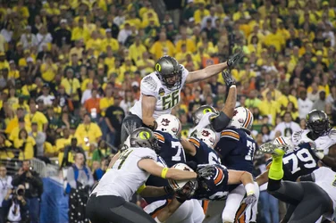

What camera are you using? This was shot at ISO 4000 at night under stadium lights on my D700. At that rating I still only got to 1/640.
For low light sports you need to be at ISO1600 +
iso3200 F2.8 you have to use the settings to gets the shot
