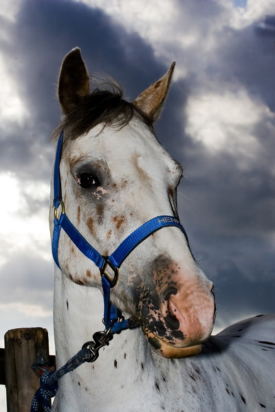

It works
Very nice. I really like number one. There looks to be some illumination in the second one, was it a continuous light?
I was just messing with on camera flash, only a quick grab shot, shot one was taken with a 5D and 200mmF2.8L
Out of curiosity, how did the horse react to that flash?
