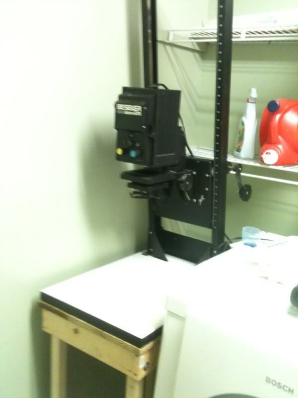

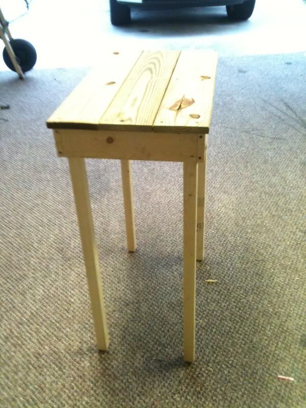

Table for the enlarger.
Enlarger in position ready for printing:

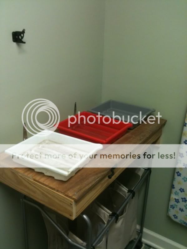

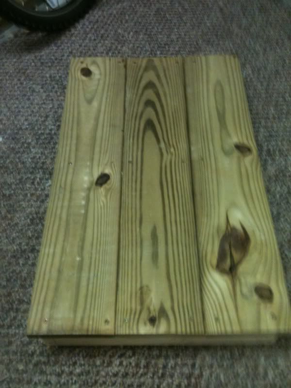

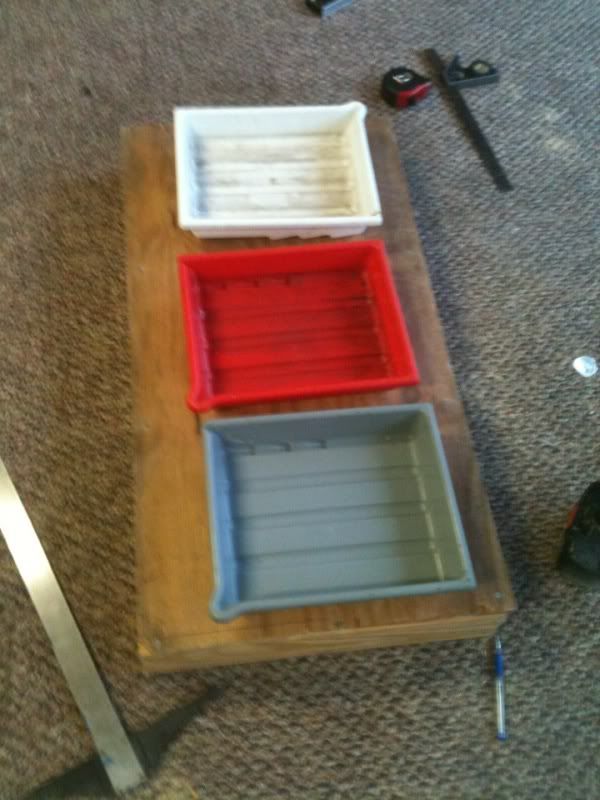

Table for trays:

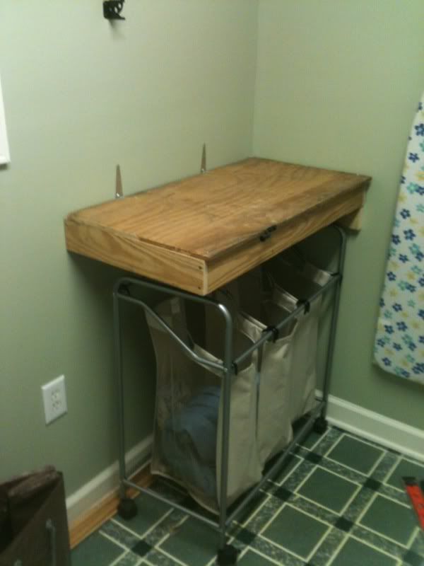

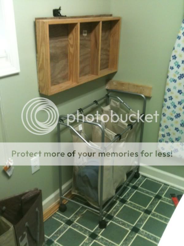

Table mounted:
Table up:
Getting ready to print for the first time in 12 years or so:

Wow! Welcome to TPF, and let me congratulate you on getting your darkroom up and running in such an efficient manner. That folding table is genius - what a space saver! I've been a big proponent for years of using available space for quick set-ups/breakdowns, and you have proved my point beautifully. :thumbup:
Personally, I have been restricted to converting unused bedrooms and cheap folding tables for my equipment (read: no running water) so I am always happy for anyone who can convert a bathroom or laundry room. I've recently moved to a house where the "unused bedroom" has an empty wall that backs up to hall bathroom, so there WILL be a darkroom sink installed here eventually - and it will feel like total luxury. :lol:

You have a good heavy enlarger - I'd get a more solid table to put it on.
Welcome to TPF, I have been toying with the idea of using one of my grandfathers old film cameras and manually processing the film myself so seeing a setup like that gives me ideas. With a little modification you could use those spaces under the fold up table as storage shelves when it is in the up position. you could put your trays or maybe the bottles with your chemicals in them. You would just have to remove them before putting the table down, which you would do anyway since you will need them for the process.
Hmm, you should get a large pan to put under all those trays ... you don't want chemistry to spill into the hamper.

I do agree with Ken C regarding your enlarger table. You want that table to be rock solid. A couple supports across the legs might stiffen it up. When using a stand-alone table as yours, I would wait a few seconds without moving to insure all viberations have subsided before beginning your exposure. Great job!
