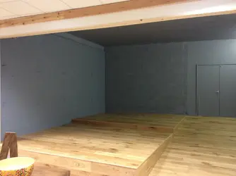

The studio we will start building in about three weeks is a room at the end of the loading bay to the basement. The room is 6m width x 6m length x 3.4m high. We are knocking one wall down and using an extra 5.5m length (This part is used for other things but can be cleared for shooting) (it's mainly for moving the camera further back).
I am thinking of using a Pantograph Ceiling Rail System. Does anyone have any thoughts? and what size would be adequate for a 6x6m room?

This is our photo room ... so far. Oak flooring with matt grey walls.
