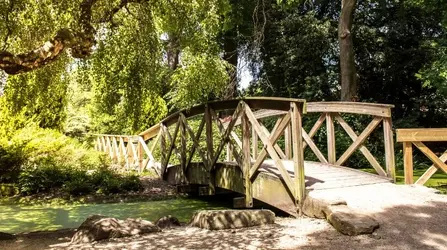

But I've never really had my photos looked at by other photographers so never had all 'real' feedback. Just wondered if you guys could take a look at some example shots i've done and give and advice you have, where i'm going wrong, ways to improve etc... Just so I'm going into this course knowing where my skill level is :)

You will get much more and better response if you post one or two shots in a thread here for critique rather than expecting folks to go off the site and review your entire body of work.
There are two main issues that I think of when I see these images -- but the primary issue I notice is the dynamic range.

This is what I'm seeing in your photograph... the area under the bridge is black in shadow (which is ok). But the area leading up to the bridge is so white that we've lost detail in the image.

I dont think the pictures are bad but like previously stated just way too bright, do you edit at all? I would dim them down a bit and sharpen them up, add a little more color and I think they could be much better. If its ok with you Id like to edit one when I get home to show you what I mean.

Michael, I did edit them a bit. I brought up the clarity and lowered the shadows (which I think has added to the brightness) and it was a pretty sunny day :)
Please go ahead and edit one (or all) I look forward to the results, if you could let me know what you did to improve them that would be great.

I dont get done work until midnight eastern us time so as soon as I get home Ill do one and post it up. If I can do what I have in my head I think theyll look pretty good. I sure will let you know exactly what I do.
Here they are

The only one that works for me is the bridge. In the other two, the apparent subject (the thing in focus) is off to the side where you don't really notice it. The frame is filled with things that would be great subjects on their own (the man on the bench in the one, the statues in the background on the other), and when I looked at them these were the things that immediately drew my eye. It was only after I'd gotten frustrated trying to see them that I noticed the in-focus items on the far right.
What I think I would do with the one of the wall is crop out the man on the bench. That way you don't have an 'obvious' potential conflicting subject - the rest of the background would be pretty plain.
