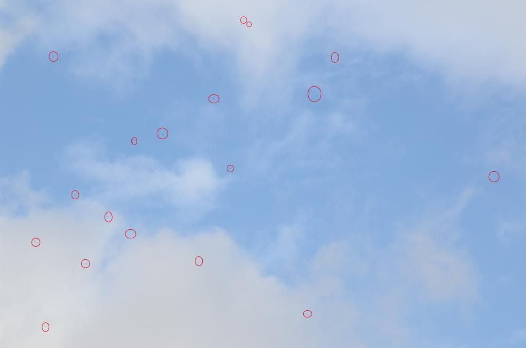

Nikon D7000 spots

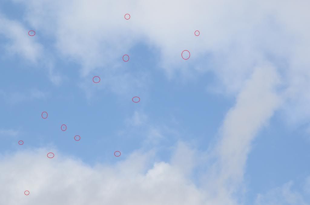

Heres a edit of the spots that i circled
Did you have it repaired? Did Nikon take care of you?
The spots show up on light colors like light blue skies or whites etc. Oil spots that are on the sensor. How does one go about cleaning the sensor? And dont say use the menu because that does nothing to help with this problem. Ive tried blowing canned air on the sensor and it doesnt do a thing either. I wonder if having the camera out in the heat softens the excess oil that splashes on the sensor when the mirror flips up?
