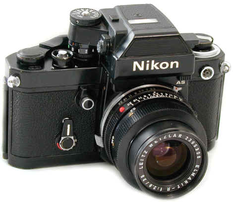

I currently have a Nikon F2 photomic 1972~ like this model:

Is your camera an all black F2as like in the photo? Because that's a pretty valuable camera, a typical F2 in great condition will sell for around $150, but a black F2AS can fetch up to $400.
