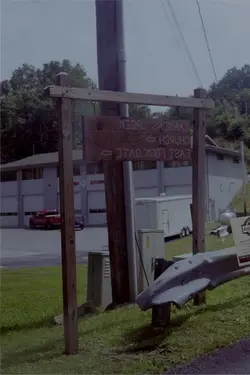

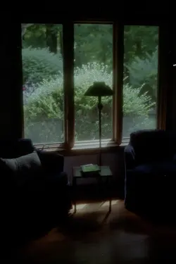

Hi, new here, been experimenting with a Nikon FE for about 6 months and the results have really fluctuated between okay pictures & totally unusable pictures. I've rarely gotten a 'great' picture unless I'm shooting inanimate objects with a light kit and tri-x, and I don't know whether it's me or a fault within the camera as it is over 30 yrs old.
First off, I've had difficulty judging exposure using the electronic two-needle system in camera. It seems wonky to me. Seems maybe 95% of the time my photos come out looking 1-2 stops underexposed. I tend to shoot expired film along with new stock, and generally there's not a hell of a lot of difference in exposure and color between the new/old rolls as it all tends to come out underexposed.
So maybe I should buy a light meter and check that exposure against the FE's?
Also put two new batteries in a couple months ago...
...and I don't think it's the lab as the negatives are always perfectly developed.
Only other thing I think could be an issue is that I tend to stack filters for neat lighting effects. I know that doing this influences exposure but I've just assumed the FE's meter would compensate accordingly. Sometimes I'll overexpose by as much as 2-3 stops and still get a dull/dark image.
So I'm not sure what's going on...
...just dropped off a roll of Fuji 400 I shot at 200 and a roll of 200 with every shot overexposed by 1-4 stops just to see what happens.
Any ideas? Buy a light meter?

Buy a good light meter like Sekonic L-758 and compensate manually for stacked filters. Who is developing your color ? And who is developing your Tri-X ?
THe first shot is "backwards", and underexposed. all the shots appear underexposed.
Are you setting the camera's ASA/ISO setting with each roll of film? Is the Aperture Coupling Lever in the "down"position, so it is actually indexing with the lens? Do you possibly have the exposure compensation (the +/- thing) set to Minus?
Sooo many questions. The first shot, the backwards one--is that a scan? What kind of film are you using?

Yeah 1st one is scanned backwards. Colors/exposure are straight from the scan, which is set to no color/exposure compensation, so what I see is straight from the negs which all seem to be underexposed (by my own hand apparently).
I was using fresh fuji superia 200 I believe, set to 200. Only time I really push/pull is when I'm experimenting with expired film. The film used in the pics wasn't expired. The shot with the window was supposed to be 2-3 stops over because I had a net on the lens, but that didn't work so well.

My question relates back to the three images shown above: those look like they have adequate detail. Are you having prints made? I mean...or, are you scanning negatives? Those three images look to me like they HAVE exposure...are you positive the issue is not with the SCANNER end of the equation??? I mean--the shots look like there is good exposure, since I do not see a lot of blockiness...it almost looks like the scanner is being fed a good negative, but the scanner's not set right.
It's tough to go off of just a few images. And like I said--the color looks weak, but the images seem to me, at some level, to look like the In-Camera exposure was "okay"...but the color is pallid, weak, desaturated, whatever one wants to call it. Makes me wonder how the images would print, conventionally?
