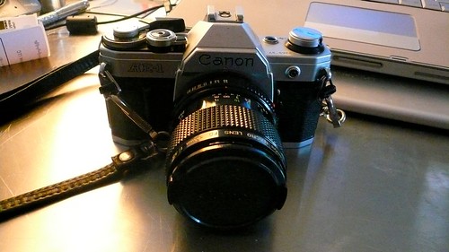

I was using the AE-1 with the 300mm. If it is caused by uder adjustment then which setting should be adjusted? The film was Fuji Provia 100 Daylight. Don't know how old it was.
How do I know if its the program? Took some pics for you.

You have the camera in manual exposure. Make sure you adjust aperture according to the meter in the viewfinder.
The Canon AE-1 has a semi-automatic mode if you put the Lens in the "A" mode. The camera will set the lens aperture automatically based on the shutter speed you set.
