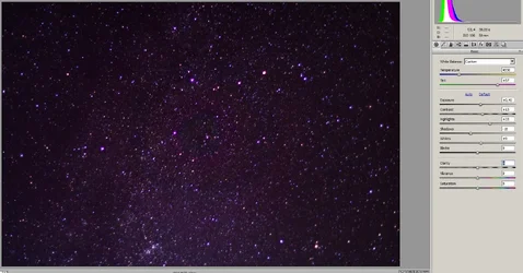

I've added a picture of the aperture blades and a picture taken with the lens on 30" f/1.4 100 opened in Photoshop Camera RAW and pulled the Dehaze slider all the way to +100 (together with the small adjustments you can see on the screenshot). I was wondering if the oil from the blades may have dripped down on the lens while in the box causing these rings to happen?

Personally, I would only accept a refund or a different lens. If a lens is prone to "oiling" then, a simple cleaning may well not fix it, and it's likely the problem will return in short order. As an aside, there actually very little oil involved here, just a couple of drops, and it's contained in the lens, so it can't hurt the rest of the camera, and it's unlikely to affect images, other than by cause exposure problems through improper opening/closing of the aperture blades.
