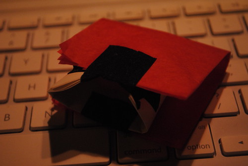

Wow, never thought of trying to diffuse the craptastic flash...Here's what I came up with as a sort-of red filter.
