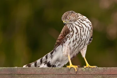

Problem: Birds don't get red eye, but I do get offcolor reflection in eyes ie; View attachment 3483
Circumstances: D80
Sigma 150 -500 @ 400-500
SB800 with Better Beamer
Outdoors, dim, cloudy light @ approx 30 ft.
Quesrtions: How do I fix?
How do I avoid?

Well, wrong photo. The reflection isn't as obvious in that one. how in Photoshop? Have Elements 10 but no skills $DSC_0038.webpyet.
Sorry for having to click on thumbnails.
Well, wrong photo. The reflection isn't as obvious in that one. how in Photoshop? Have Elements 10 but no skills View attachment 3484yet.
Well, there's always a dozen different ways to accomplish something in PS, so... Just looking at it, I might just paint the pupil black, sparing the highlight glint (or maybe not sparing it), and see how that works out. That would be the most straightforward way to deal with it.
If it didn't look right, I guess my plan B would be to selectively adjust the affected pupil with contrast, brightness and color desaturation.
As for the iris, that's looks like a straight paint job too, with some yellow from the surrounding area sampled and used on the problem areas.

It is an easy PS fix.. I did these just for fun.....
