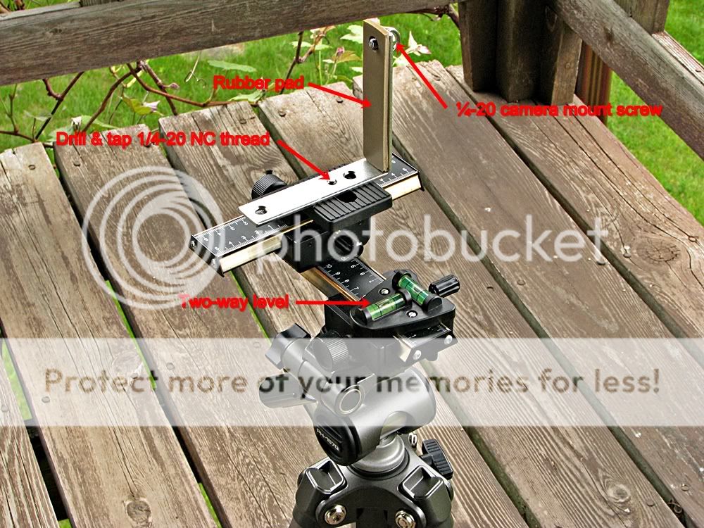

1. Tripod
2. Camera level
3. Portrait orientation
4. Lens over point of rotation
5. Overlap of frames.
