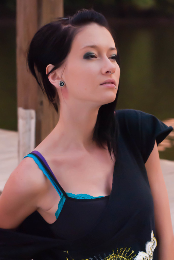

Photo Heavy! From Model Shoot

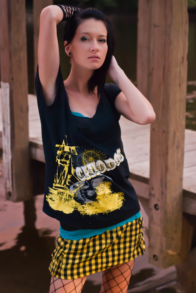

Your white balance should be the same across the photos taken with ambient and the same across the ones with flash. Find one that works on each, and match the wb in post across the photos. It is definitely not consistent, that is quite visible.
What flash are you using? And are you ever using a TTL cord or is it all on camera?

I use SB-700 and I don't use a cord. I'm still a beginner so I'm trying not to learn too much at one time and am just happy these photos weren't blurry honestly & that I can now learn more about WB & making photos that are pleasing & not all over the place! When I upgrade camera's I plan to start learning off camera lighting more. I have read about it and watched tutorials and know some of the basics but I am not knowledgeable about anything extensive.
On camera flash is the best way to make the flash completely unappealing. Try out a TTL cord for like $15 bucks, you won't regret it. Or use your reflector with the flash bounced off of it. It's not a rule, but I stay away from straight-on flash as much as possible. It creates unappealing shadows and highlights on people. Or use the CLS system and stick the 700 on a stand off to the side and play with the lighting effects. Have fun, discover new things!
(If you dont know about CLS, look it up, it's built in to your Nikon camera and flash. :) )
I just hate having the pop-up flash as the commander, so I use TTL cords more than CLS.

I like 10 and 13 the best. I agree with pretty much everything that has been said. My main 2 issues are the color/WB issues on a few of them, as well as some of the compositions needing a little help. ( #1,6,7 and 8 jump out at me as needing better compositions) Too many pics to get too in depth though.

I prefer the second set of photos - 10, 11, 12 and 13. Initially I thought photo 10 might have been better in portrait mode but then you would have cut out that atmospheric backgound which would have been a shame. The background in photo 12 is busy and should be distracting but I think it works. Nice work :thumbup:
I like #10. I notice you cropped very tight to the top of the head on some of them. Give her some room to breath! :D
