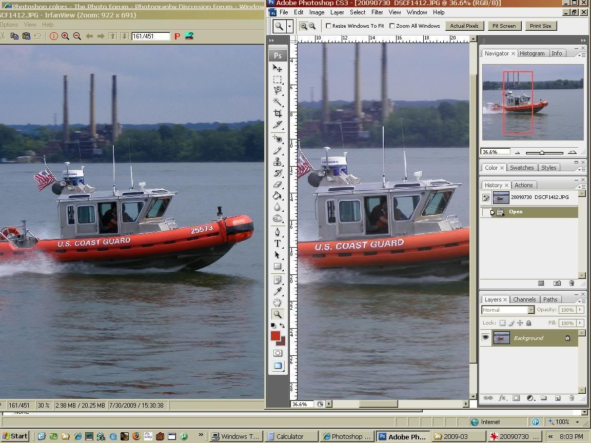

Here is a screenshot of the same image opened in Irfanview (left) and Photoshot (right). This image is the original straight from the camera. I only opened it in each program and did nothing else except zoomed to fit the example. When viewed in a web browser it also looks the same as the Irfanview example. With Photoshop, the image looks washed out. Thus, if I edit to look good in Photoshop, it is way over contrasty when looking in any other program. (Sorry, I saved this screenshot in Paint. Didn't want Photoshop to mess any colors up with it so the JPEG compression is quite horrible.)

Well, after posting that last night, I was going to head to bed as I felt like I was coming down with something (I am, I really feel like crap this morning) but I went through the menus in PS once more. Now that I'm at work without PS on this computer, I can't remember what it was. I think EDIT -> down on the bottom there are 3 items pertaining to color. I clicked on the first one and played a bit in that. It was set to custom and some of the stuff was set to use sRGB with a bunch of numbers. I set the "custom" to "monitor color" and now everything looks the same.
So again, thank you if you were about to come back to help out some more. Much appreciated and I think it's all sorted out now.
