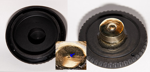

Here is my Pinhole lens:

Pardon my ignorance, but is that just a body cap with a whole through it? What's the raised gold bit?
Yup! The gold (brass) bit was made to move the aperture farther out to fill a full frame sensor. Just putting a hole in the body cap gave a small circular image.
I think this is a 60mm pinhole lens. :lol:

Yeah, my first was a hole drilled directly into the body cap. the size of the hole and the thickness of the material effect the softness (difraction?), as well as the shape of the hole.
Pinholes can actually be complicated, depending on the desired effect you want. The size of the hole needs to change with it's distance from the sensor, if you are aiming for perfection.
