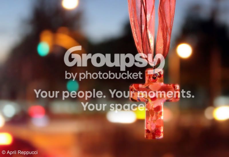

here is an example. I made the background blurrier during the post process. Sorry, its the only example I have in a pinch. its the cross hanging from my rear view mirror and I took the shot at a stop light.
aperture and focal length create a shallow DOF. The widest aperture of your two lenses is f/3.5; that's not a very wide aperture and won't create an extremely shallow DOF.

As V.I. mentioned, the biggest obstacle is that your lenses are limited. They only have a maximum aperture of F3.5 to F5.6, which isn't considered very large. And as we know, it's a large aperture that helps you create the shallow DOF that you are after.
Bokeh junkies usually prefer to shoot with prime (non-zoom) lenses because those are the lenses that can have larger max apertures. Three examples from Canon; 50mm F1.8, 50mm F1.4, 50mm F1.2.
Also, the size of the film/sensor will make a difference. Like most digital SLR cameras, your T2i has an 'APS-C' sized sensor. It's much better than what is in a point & shoot camera, but it's still smaller than a 'full frame' sensor like what you will find in the 5D.
So when you see photos on the internet, you may be looking at photos taken with larger apertures and larger sensors...which is one reason you are having trouble replicating them with your gear.
And of course, the distance to the subject and the distance from the subject to the background will also have an effect on DOF.
