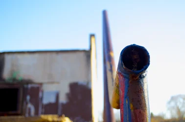

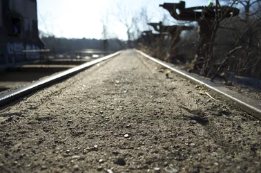

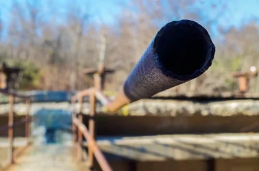

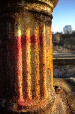

Hey, so I was trying to get some hokeh with my kit lens. Isn't super easy, but this was the best I could do at the time, at Belle Isle. What do you think of these photos?
I like the hydrant (?) the best, the colors are awesome and the DoF is splendid, making for some nice Bokeh.
What you were trying to accentuate was "bokeh" not "hokeh." Having a shallow depth of field is inherently easier with a long focal length, and a large aperture is a plus too. Your depth of field will be shallower fully zoomed in with your kit lens than it would be at 18mm.
As for the photos... Well, you're new to photography, and probably this forum. So I'll keep it to myself. Keep shooting!
Sorry, hokeh was a typo. If you look, b is right below the h. I had my fstop as low as I could get at 3.5, but to do that I had to not zoom in, so what are you supposed to do? I've been doing photography for almost a year now, and if you look "I spend too much of my life on TPF!" so I'm not too new, but still warming up to the forum I suppose.
I'd like to know what you think of the photos- not telling me anything won't help me learn, but just be nice about it if at all possible! :D
