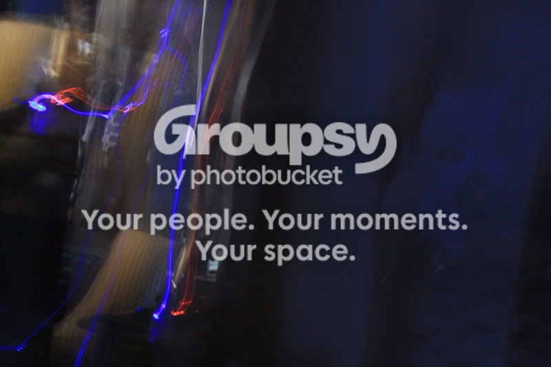

here is one of the last photos I took. When I use manual focus it doesnt seem to happen, when im using auto focus the flask will blink a few times and not take a picture. I tried messing around with the av settings as well.

You're using a program exposure mode (Landscape) and shooting in conditions dark enough to require a 6" shutter-speed. Switch to a mode which will allow your flash to operate.

That isn't lag - that's long exposure times.
Yes, it'll do 5 frames per second - but if your exposure time is set at 6 seconds, it will do 5 frames in about 30 seconds.
It's just too dark, and whatever mode you have it on isn't using the flash, so you're getting a very long exposure time.
You gotta either use the flash, or wait till the sun comes up... (Or use a tripod.)
Depending on how dark it is, you might be able to just crank the ISO up... How high does the ISO go on the 40D?
If you're getting 6 seconds at ISO 100 (I'm assuming that's what it was - tirediron says it was 6 seconds, and it was probably ISO 100) ... you would have to increase the ISO all the way to 25600 to get a (hand-holdable) 1/40th second exposure time. ...Pretty sure the 40D doesn't go that high.

I think the question "What mode is the camera in (Av, Tv, M, etc...)?" still needs to be answered. The EXIF data for the example pic you gave shows you are shooting in Landscape Mode... is this the mode you intended? If so, the camera is doing as it should. Lanscape mode does not use flash and will adjust the shutter speed to match the available light. If this is NOT the mode you inteneded, what mode are you shooting in? (what does the dial on the top left of your camera say?)
